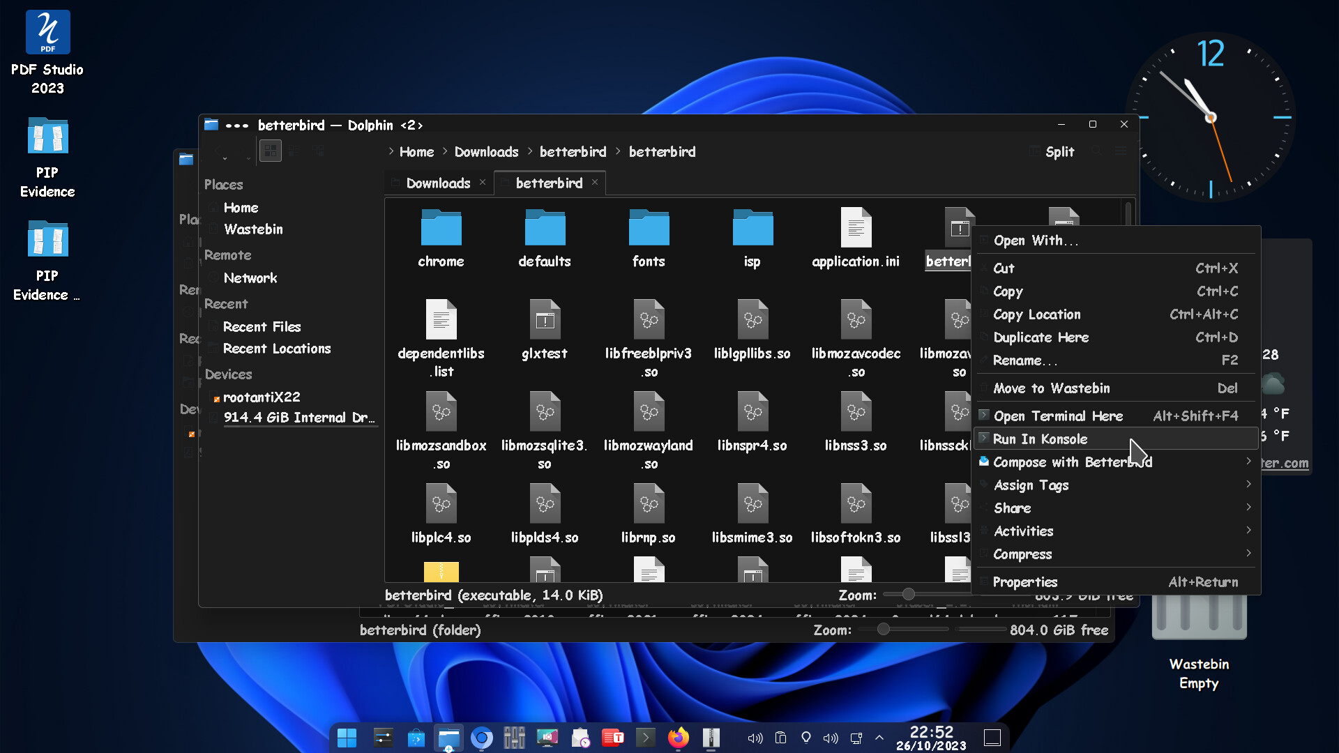

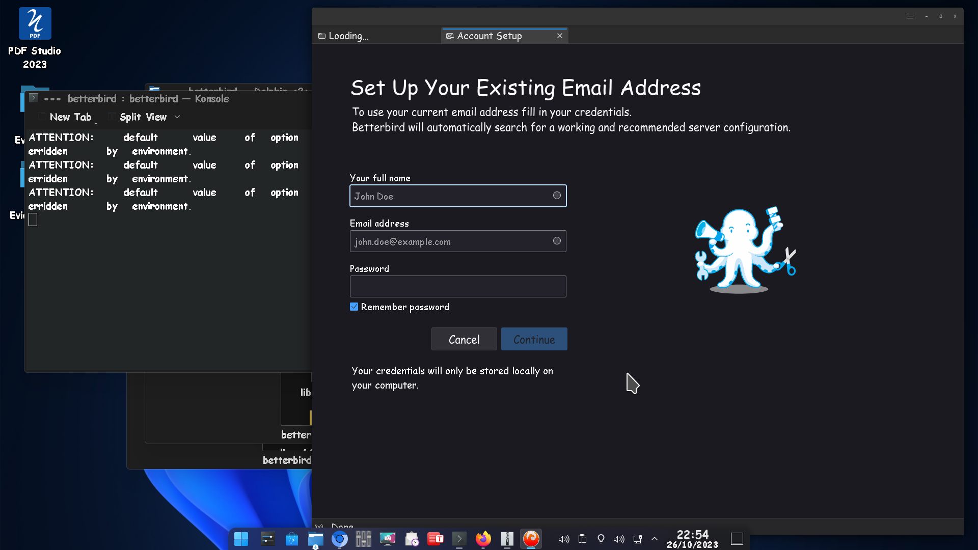

You could also take a look at Betterbird:
The Linux archive provides a tarball (tar.bz) of the application which will have to be extracted using Ark and then compiling. Is also available as flatpak but the tarball would avoid having to use that.
Actually, no need to compile. You might want to make a folder named betterbird on the desktop, extract the tarball into that folder and then right-click the terminal file named 'betterbird', run it from terminal as an executable and it will run on your desktop:

After Thunderbird's latest update it started opening my browser and going to a site asking me to donate to Thunderbird. I didn't mind the opening screen of Thunderbird asking for a donation but opening my browser was getting too intrusive. I saw a post about Betterbird on the LM forum and people were going to it because of multiple problems with the updated Thunderbird.
I decided to try Betterbird and was pleasantly surprised how easy it was to set up. I now have it on my desktop with two email accounts with one of those accounts being my Gmail which I use just for junk stuff. I also have it set up now on my laptop with my main email account. So far I have had no problems at all with BetterBird. I highly recommend it.
