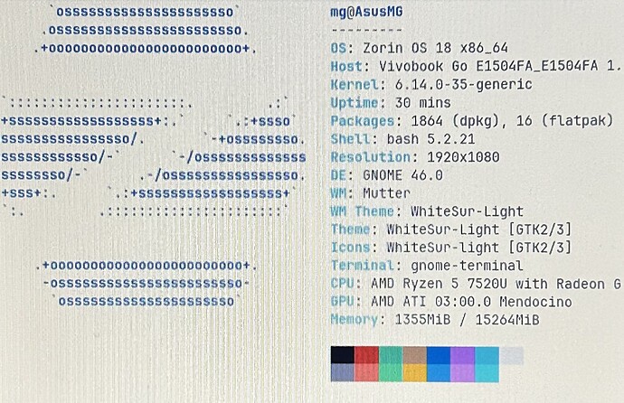

I heard TP-LINK Archer T3U Nano usually works with Zorin via plug & play
MT7902, right?
Those do not get along with Linux.

This is awesome, so you think Nano will work with the latest Zorin Os Core? Kernel 6.14?
The manufacturer doesn't provide official support for it, so we have no way to tell for sure. But there are reports from people that have made it work, for example:
https://forums.linuxmint.com/viewtopic.php?t=447966

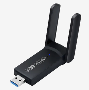

Hi, sorry to bother you with a question. Do you think it might work? It's a Realtek chip RTL8822.
I suggest you also do a websearch using "RTL8822 Ubuntu 24.04" assuming you have Z18. (i.e. Z18=Ubuntu 24.04)
Also check this: GitHub - RinCat/RTL88x2BU-Linux-Driver: Realtek RTL88x2BU WiFi USB Driver for Linux
Unfortunately at some point you'd have to just try it. Hardware support for Linux is not as good as it could be since the consumer market share is simply not that big, and manufacturers don't test their products as thoroughly for Linux, if at all. But keep in mind that you can probably return within a few days at least, no questions asked.
