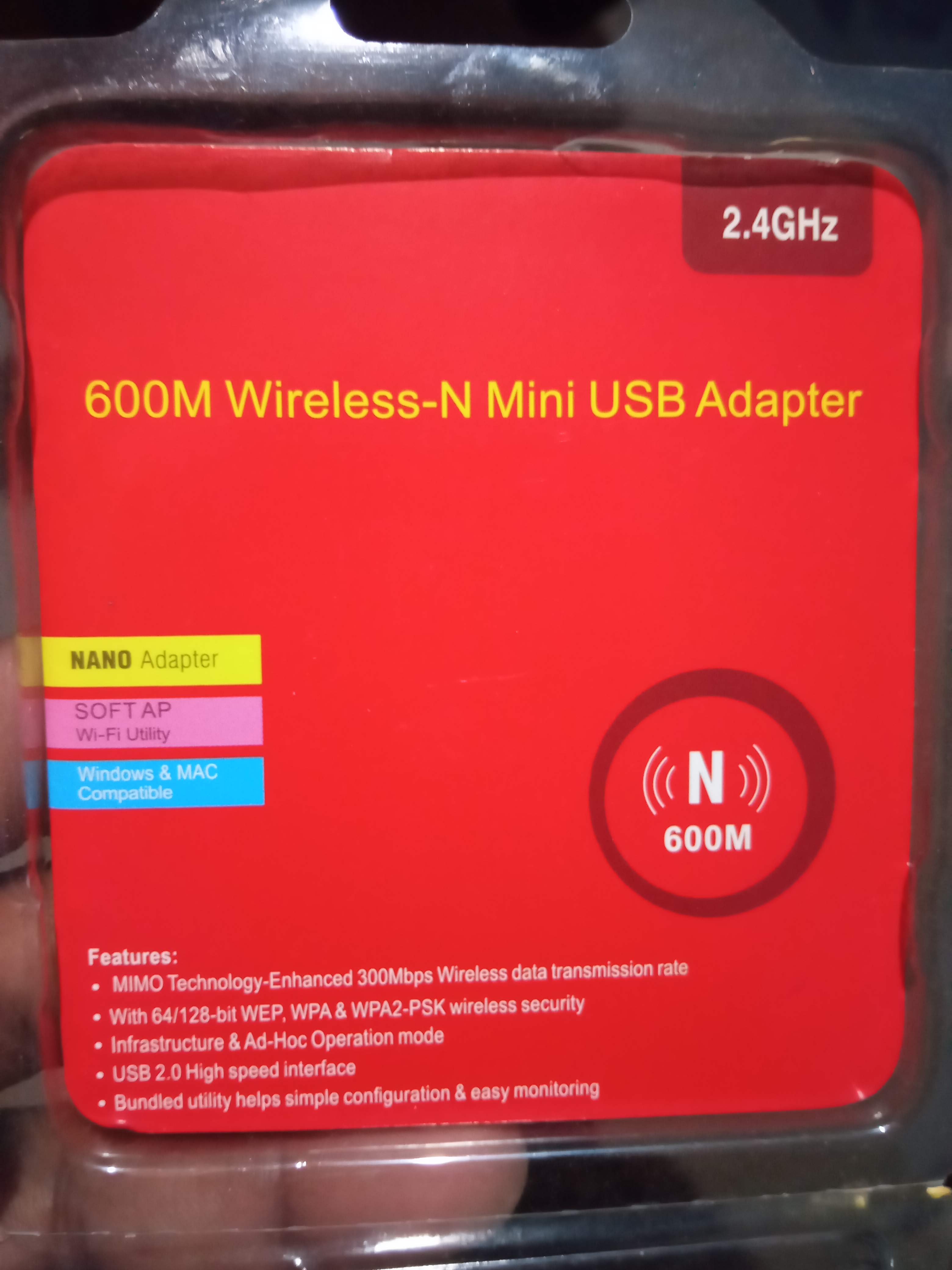

I tried this but in "additional drivers" option "No Additional Drivers" is showing. I have 600M Wireless-N Mini USB Adapter "802.11N" please help me I am very upset.

Do we actually know what specific chipset the OP's dongle has, other than it is Realtek?

USB network - is that a Wifi Dongle?
Yes this is a wifi dongal.
Wifi Dongles are not always supported in Linux...
If you can provide the make and model, we can try looking it up.
