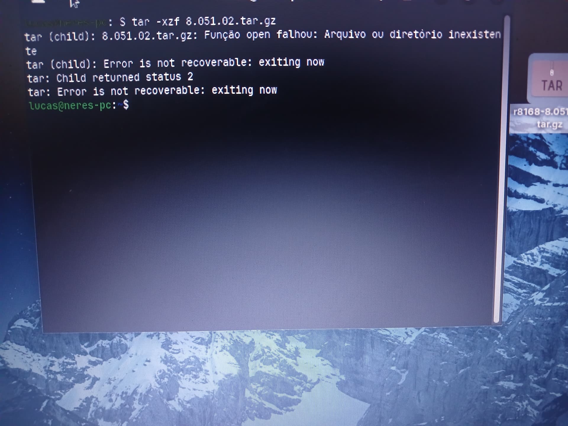

downloaded the archive on my phone and sent to the pc through zorin connect.
when i run the first command it gives this

The error you show is saying you ran that command without being in the directory that contains the zipped file.
Did you cd into the directory (change directory)?

after sending to the pc i moved the file from the downloads (standard path to files moved to pc through zorin connect) to the desktop.
Perhaps
cd ~/Desktop/r8168-8.051.02
it says theres no such file or path
I am sorry, I see now - I am the one made the mistake.
You must extract the tar first:
cd ~/Desktop
tar -xzf 8.051.02.tar.g
cd r8168-8.051.02
sudo ./autorun.sh

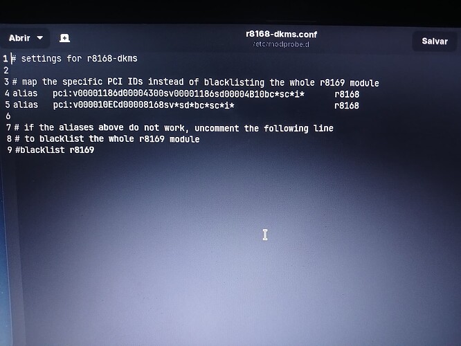

/etc/modprobe.d/r8168-dkms.conf:# map the specific PCI IDs instead of blacklisting the whole r8169 module
/etc/modprobe.d/r8168-dkms.conf:# to blacklist the whole r8169 module
/etc/modprobe.d/r8168-dkms.conf:#blacklist r8169
Here we go... If you want to remove those lines as per the instructions above here, then once removed, save the file, update initramfs and modprobe r8168 also detailed above...

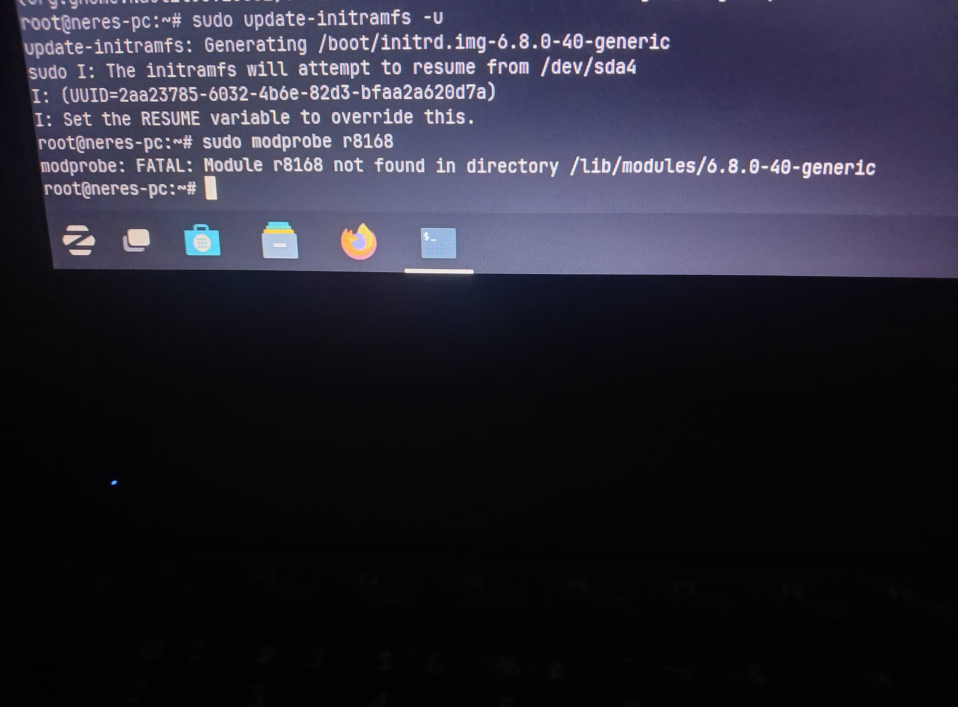

Once all the above is done, in terminal, run
sudo update-initramfs -u
sudo modprobe r8168
i found the r8168-dkms.conf file, should i delete its content or the whole file?
didn't find anything mentioning r8168 inside blacklist.conf, should i proceed with the other commands?
You can delete each r8168 file in the blacklist directory. Once done, you can run the other two terminal commands.
i deleted only the aforementioned file and since i didnt find any other file with r8168 in its name i followed with the commands, these are the results
Ok, have you rebooted and tested since removing the blacklisted entries?
