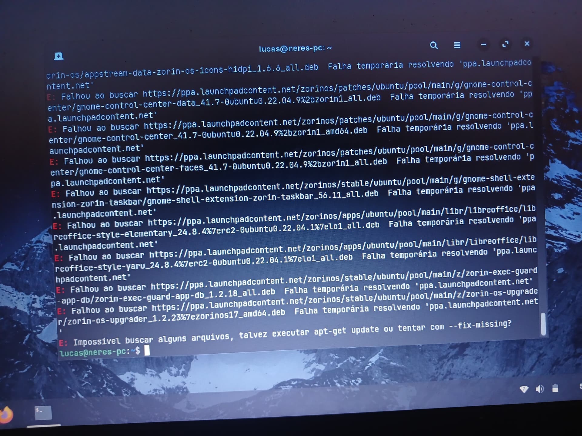

open a terminal (ctrl+alt+t) and type
and press enter and wait for it to update and upgrade
see if wifi works then
It requires to have internet connection to run these commands that will update your system. Can you hotspot it via your phone to update the system?

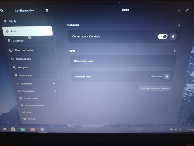

When You go to Settings>Network what does it show?

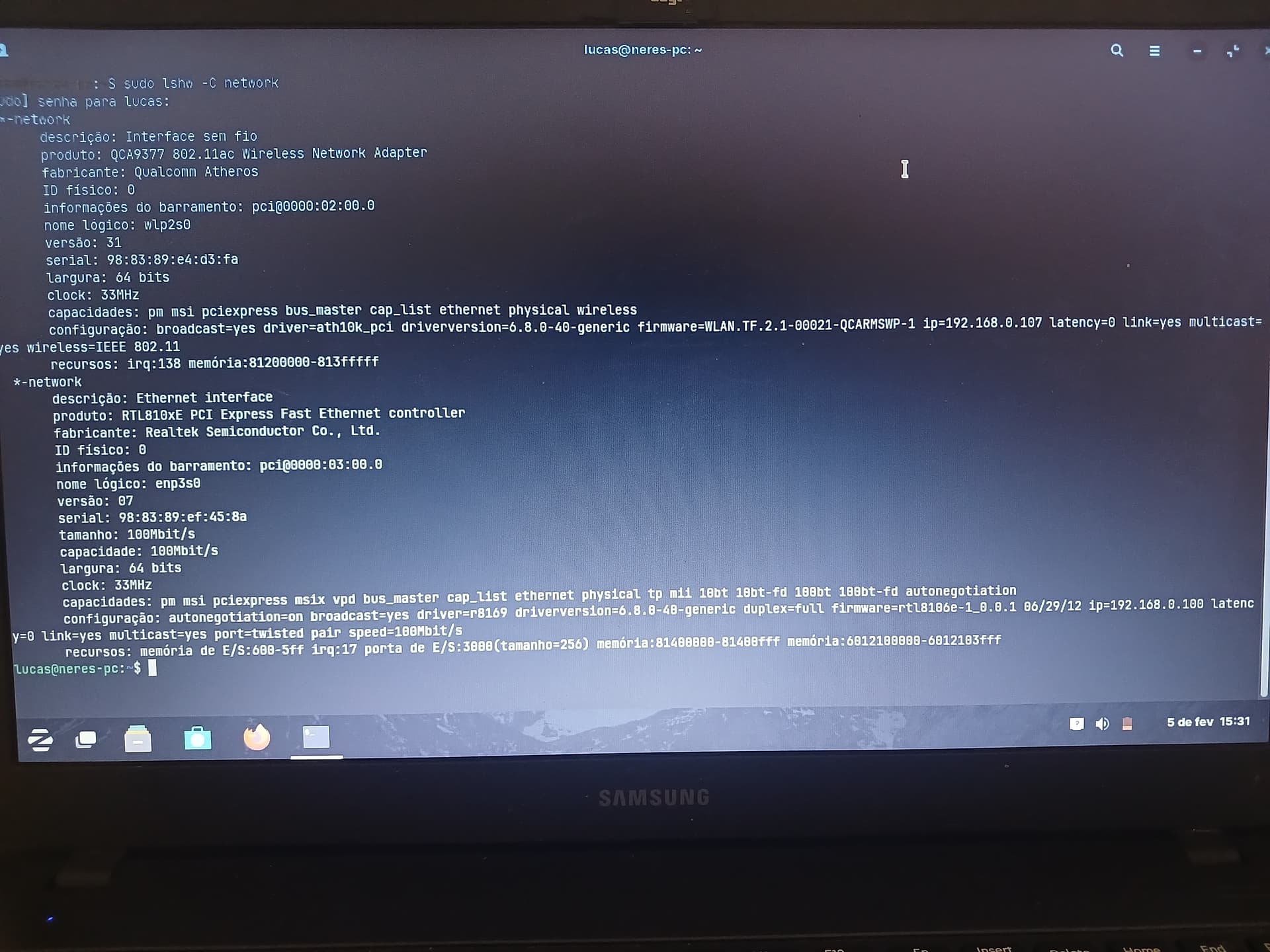

In terminal, please run
sudo lshw -C network
to see what Network Card you have. You may have Broadcom card which is carried by Proprietary Drivers.
Distros are not legally permitted to provide them, though the End User may freely download and install them.
Or it may be a different card that needs a specific driver.

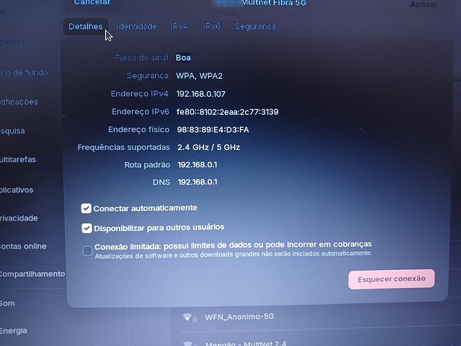

that's what it shows

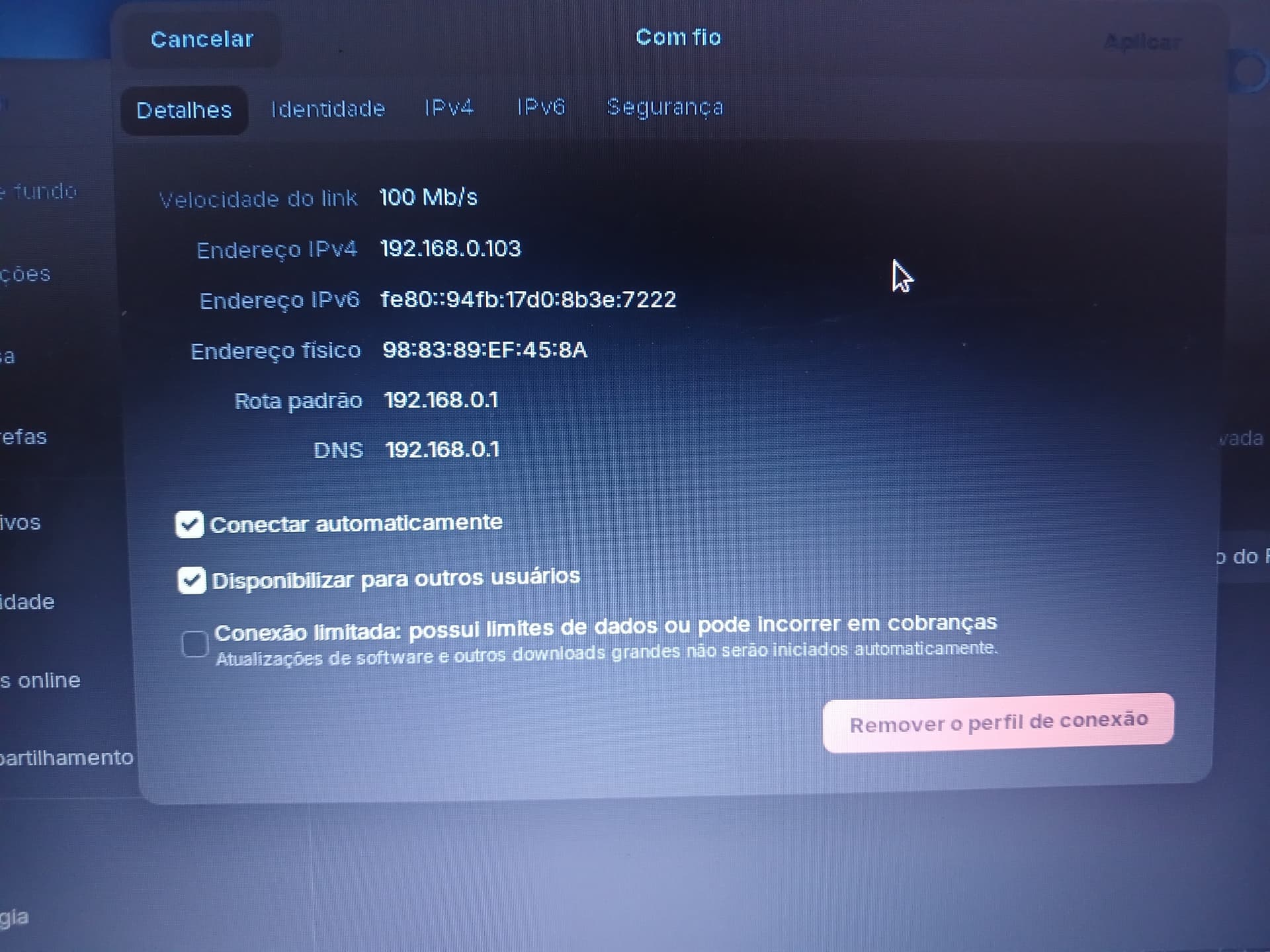

When You click there on the Gear Icon, what does it show? And when You choose Settings>Wifi?
Normally I would ask if You take a Look ain the ''Additional Drivers'' tab in Software & Updates if there is a Driver offered, but without an Internet connection it wouldn't work ...

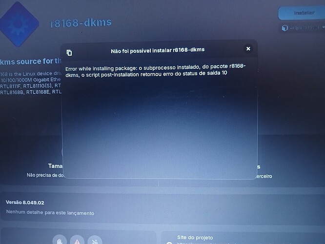

The first link is not working so i tried downloading the ethernet one and executing it on zorin but it gives the message:
Error while installing package: subprocess installed package r8168-dkms, post-installation script returned exit status error 10
Which kernel are you using?
uname -r
That error likely suggests that the DKMS failed to be able to recognize the kernel. This may happen if you are using a very new kernel.

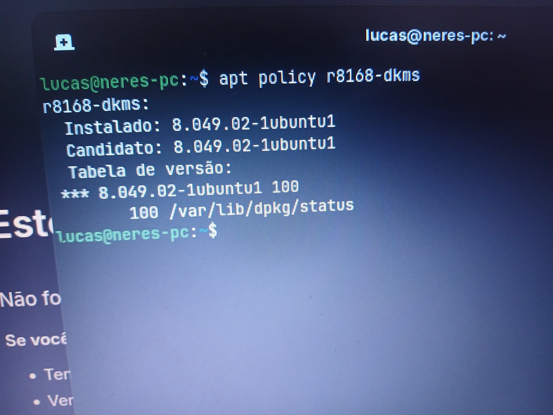

What is your terminal output of
apt policy r8168-dkms

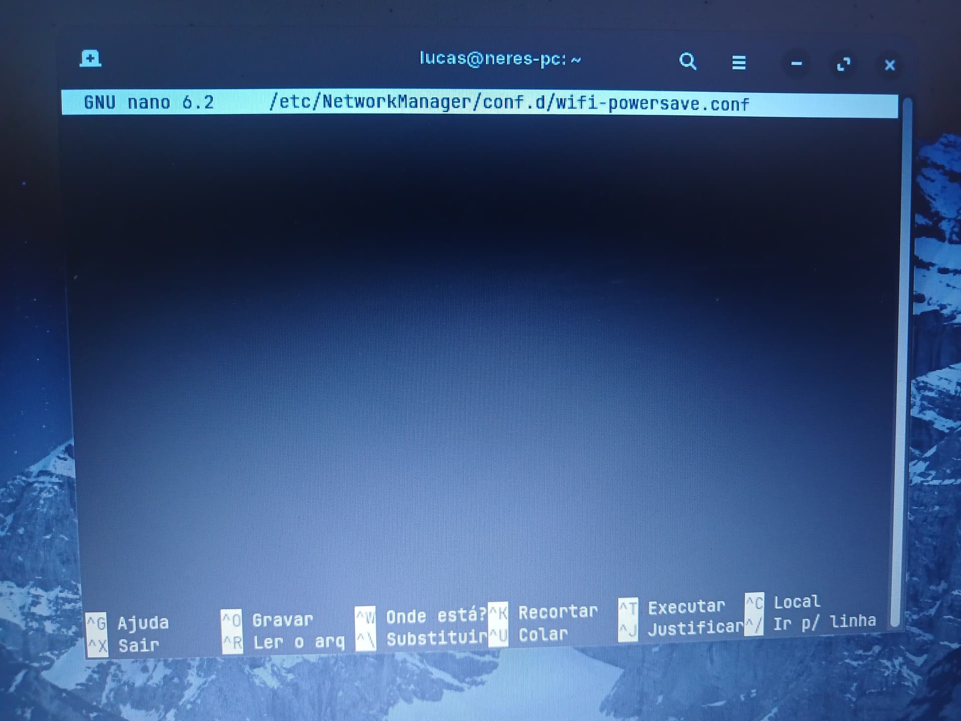

EDIT: After thought: You might disable powersave affecting networking if you are using a notebook computer (laptop):
sudo nano /etc/NetworkManager/conf.d/wifi-powersave.conf
Change value to 2
[connection]
wifi.powersave = 2
Your net might be included int he kernel - I wonder if it is being blocked by powersave. This is a bit of a guess but... worth trying.
The first command gives this:
The second one gives: ((idk where to put the third one))
! also, question mark is back
Interesting. That shows it as installed.

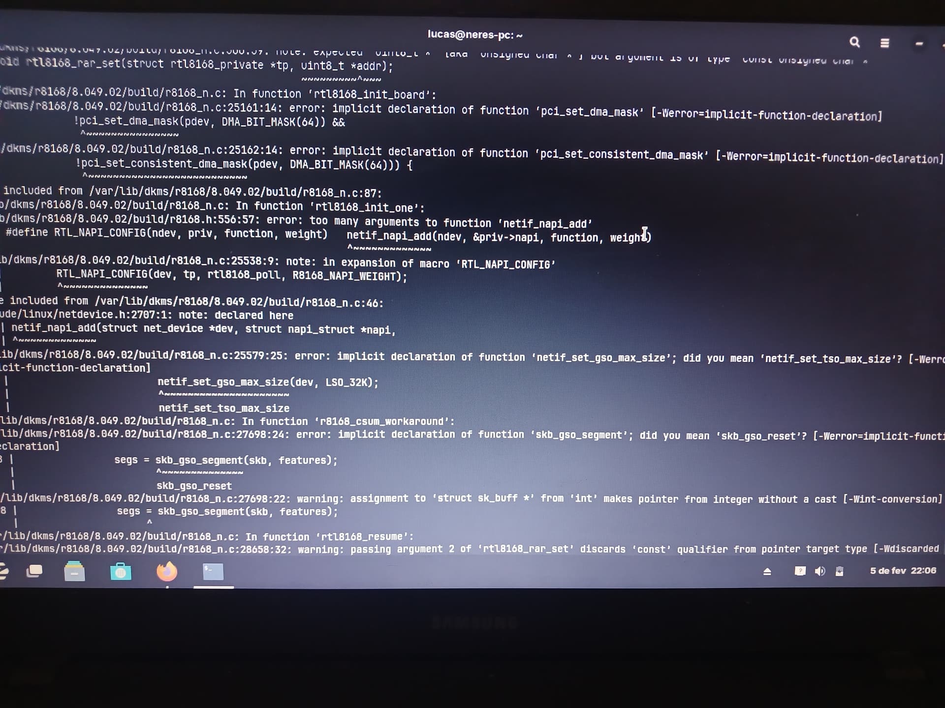

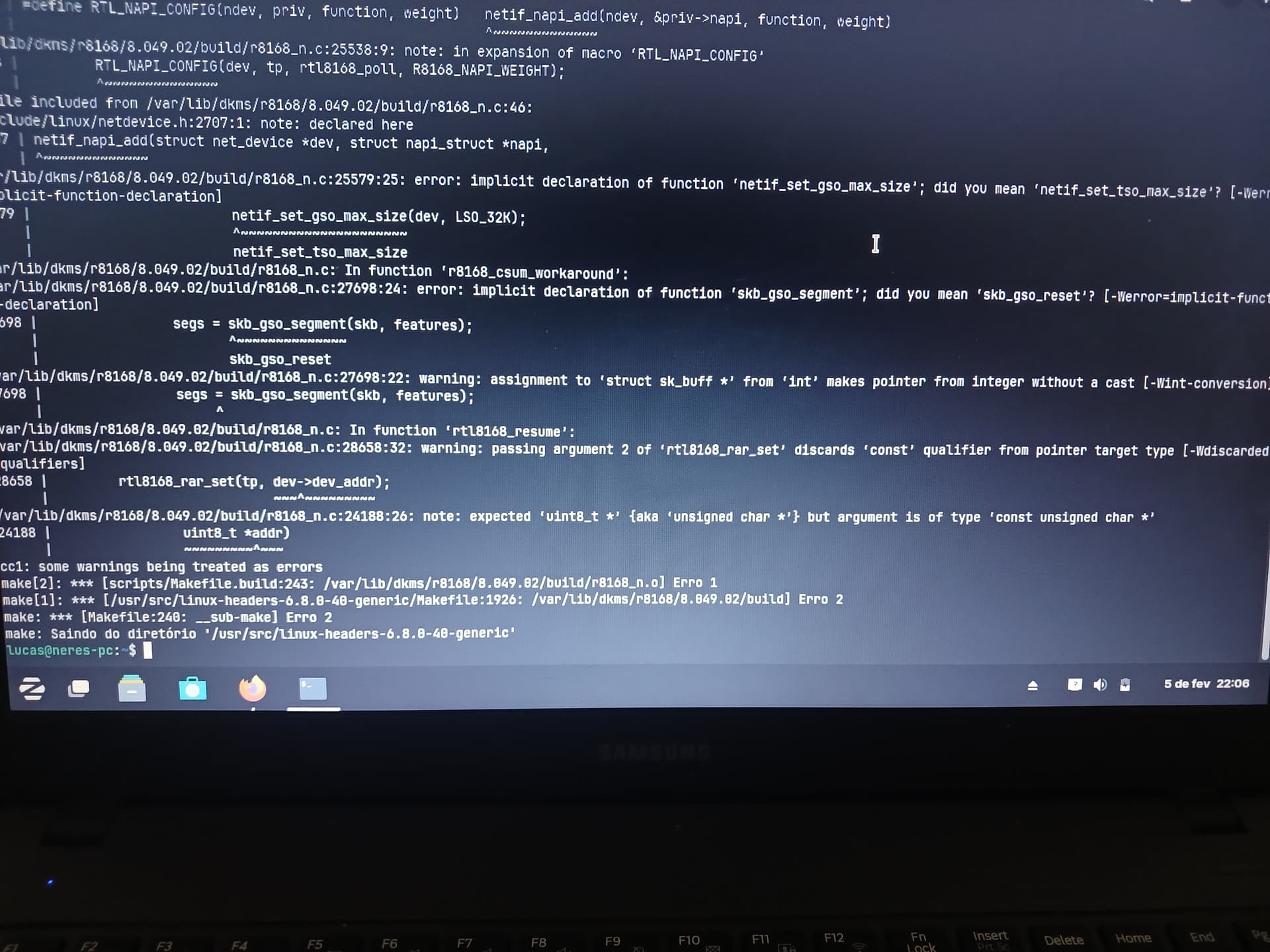

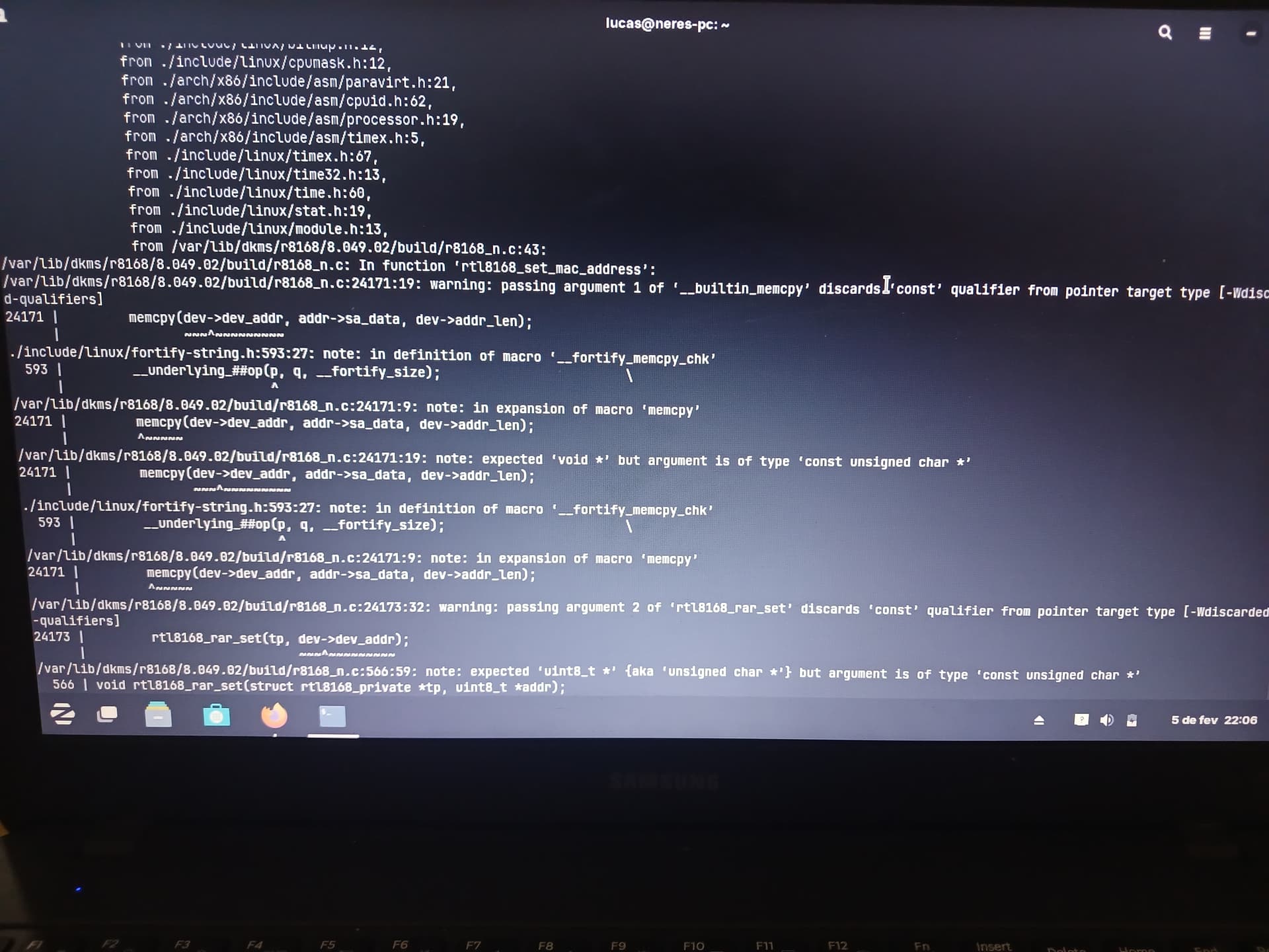

Let's look at
dkms status
cat /var/lib/dkms/r8168/*/build/make.log
Looks like we are back to looking to see if it is the kernel...
Are you using a Notebook Computer?
This shows error number 2 against the 6.8 kernel.
