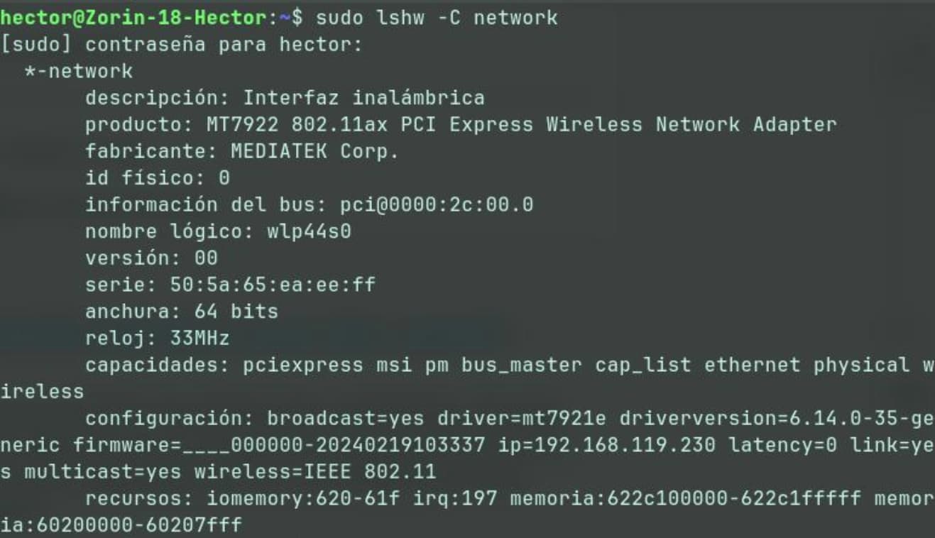

Please post the terminal output of
sudo lshw -C network
here to show us which driver is used.

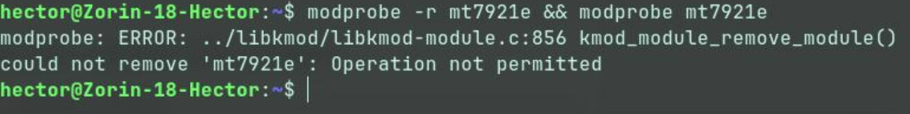

sudo modprobe -r mt7921e && sudo modprobe mt7921e
(you can test if they work after suspend to activate the wlan. If yes, add them to autostart - create a launcher with these commands.

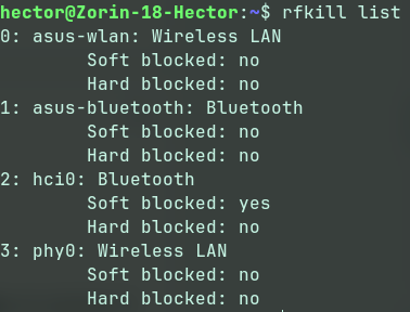

  • Can You post the Output of rfkill list in the Terminal?
The drivers:
I've tried the solutions in the forum but none of them worked.
When running the modprobe command manually, It shows this error:

Please add sudo to the command, the command was wrong. I changed it above.

Output of the rfkill list:
The terminal doesn't ask for password, It gives no output, and I can't type anything else.
I see here 2 Wifi Options. Do You have 2 Wifi Cards?
Nope, I only have one, which is the MediaTek MT7921.
