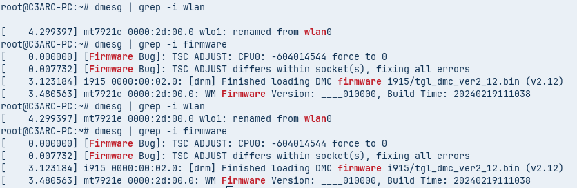

Here it is : first when it works, then after the wake when it doesn't work
Doesn't seems to have a problem here but maybe you'll see something I don't
I agree, nothing of interest there. That is referring mostly to your intel CPU.
But... it does mention you are using mt7921e - and that helps.

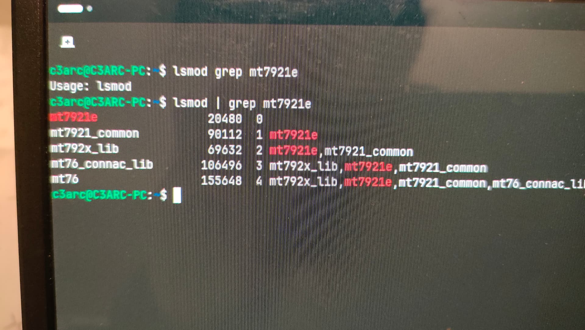

You can close that terminal out (See? You're not a mess, after-all) and in a new terminal, see if the process is listed:
lsmod | grep mt7921e
bit sketchy but here you go, seems to be here
btw I haven't restarted my pc so if you want to make some test when the problem is here, I can keep it in this state and use my phone to answer
The above shows the modules as active, but likely uninterruptible kernel sleep.
Well. Yes, I think this is a firmware issue. The module loads and works. You put the computer to sleep - it fails to unload. On wake, it is stuck in that state, which blocks the state from being unloaded when you tried above in terminal.
So rather than it being ended, then failing to init... it never ends, and therefor cannot reinit.
