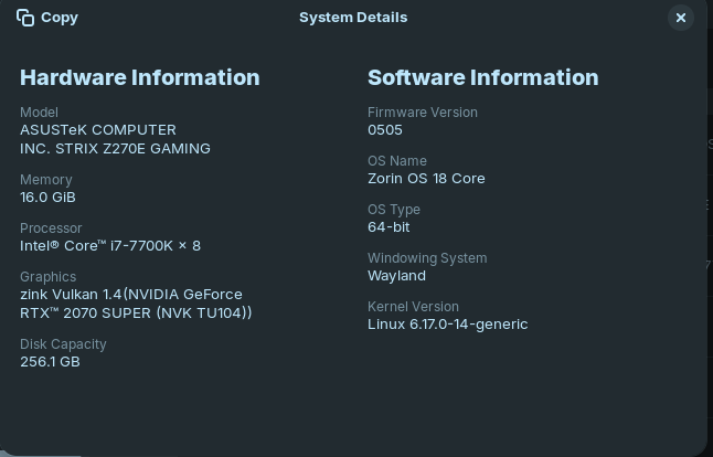

My system info is below.

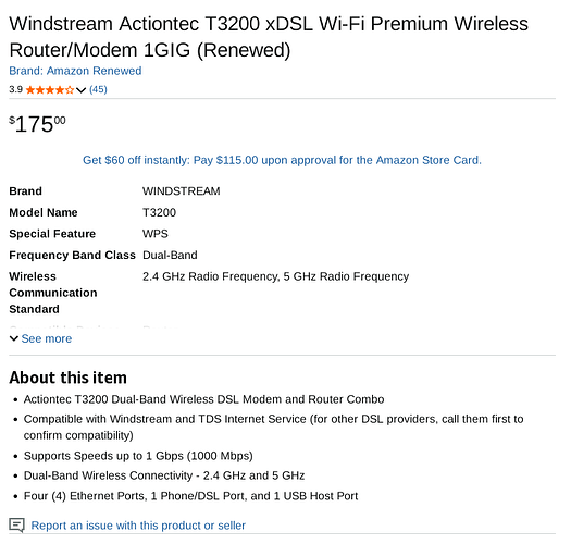

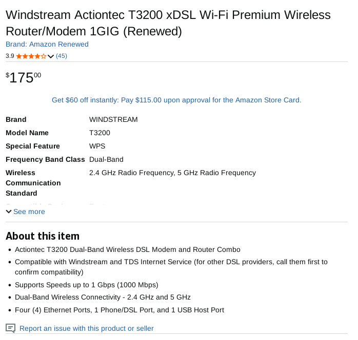

This is the router I am using:
