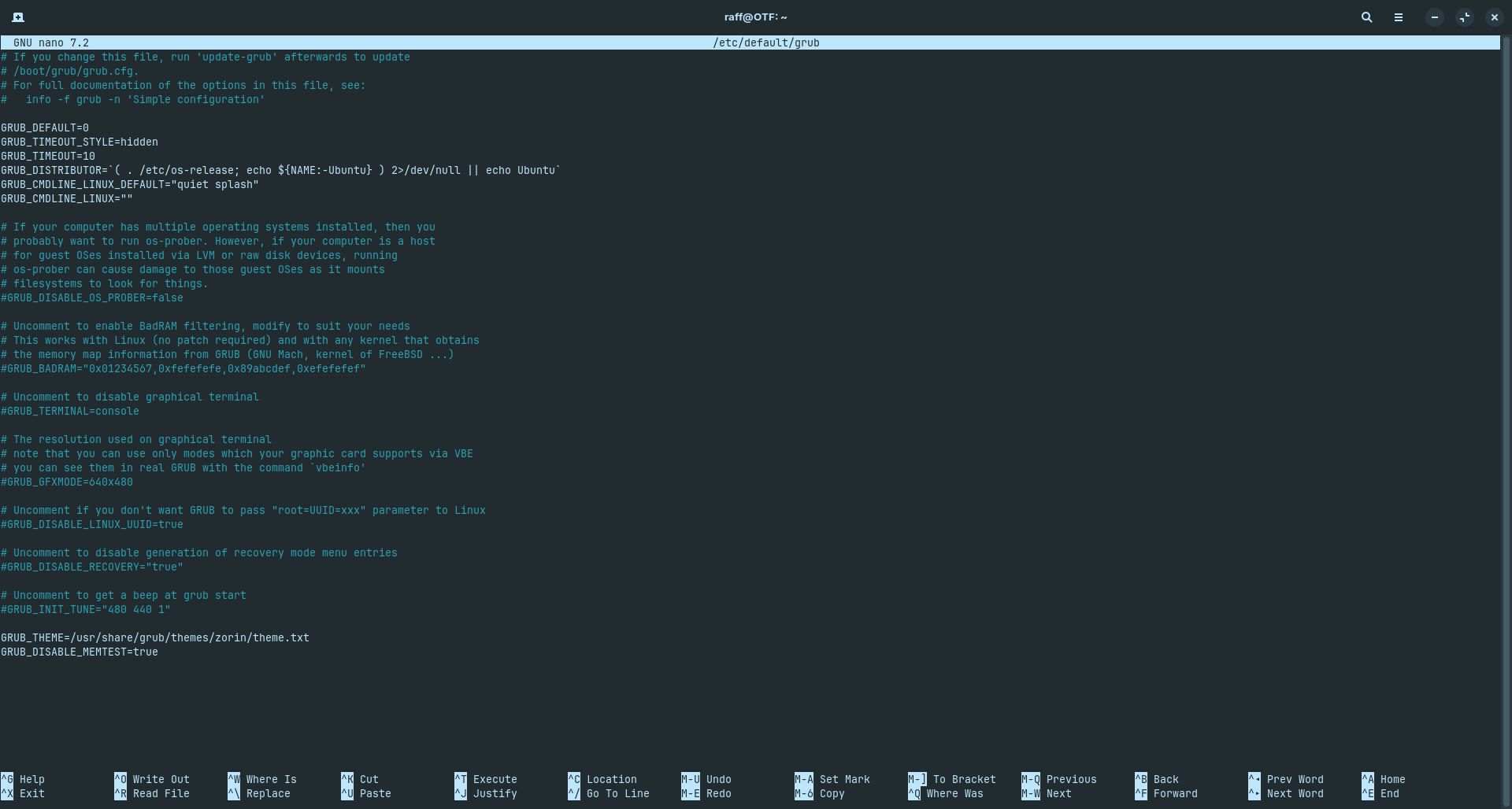

After the word splash
Change to
GRUB_CMDLINE_LINUX_DEFAULT="quiet splash pcie_aspm=off"
Then tap ctl+o, enter key, then ctl+x
Run
sudo update-grub

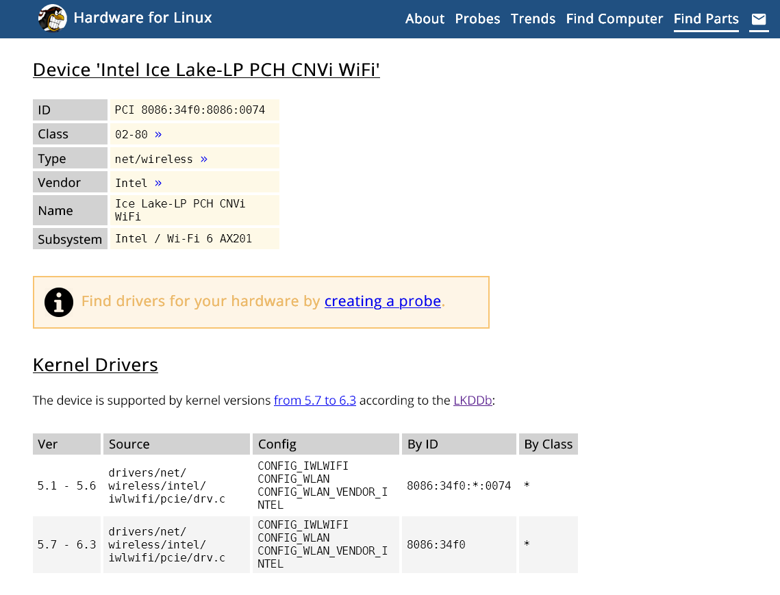

FYI. Says OK for kernels 5.7 to 6.3. https://linux-hardware.org/?id=pci:8086-34f0-8086-0074
