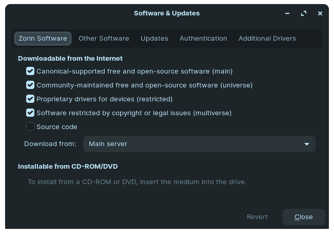

Everything there looks fine. The unchecked entries are Source Code.

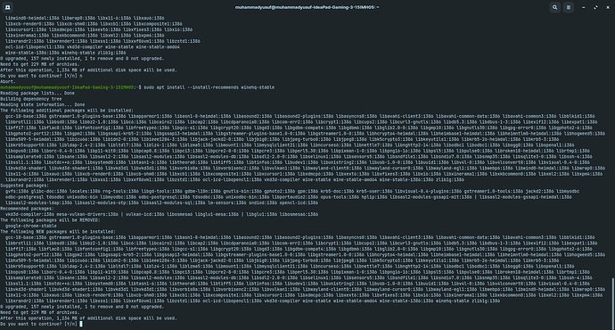

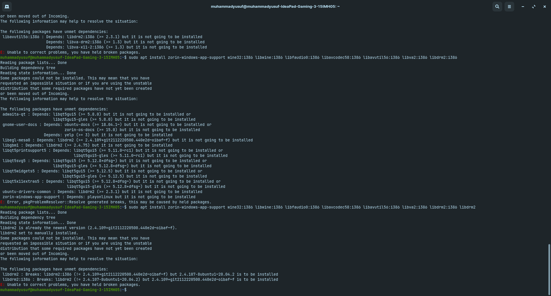

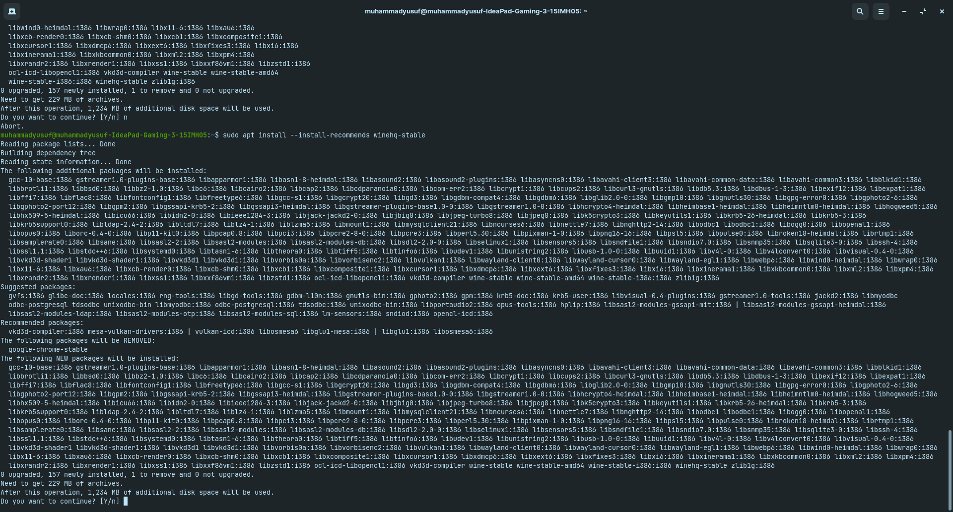

I have tried to write all conflicting packages to install and have gotten this. I think it can be useful to find the source of the problem
Please Do Not attempt to install i386 packages. This can break Zorin OS and is unnecessary to do.
The packages needed for 32 bit support are in add the 32bit architecture and in wine32, not in wnie32:i386.

Going to wine repository
It is going to remove google chrome. Again

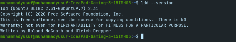

This looks a lot to me like a Libc6 bug.
What version of Libc6 do you have?
ldd --version

Are you certain that in Software & Updates, you are set to Main Server?
Any questions. I will answer them all

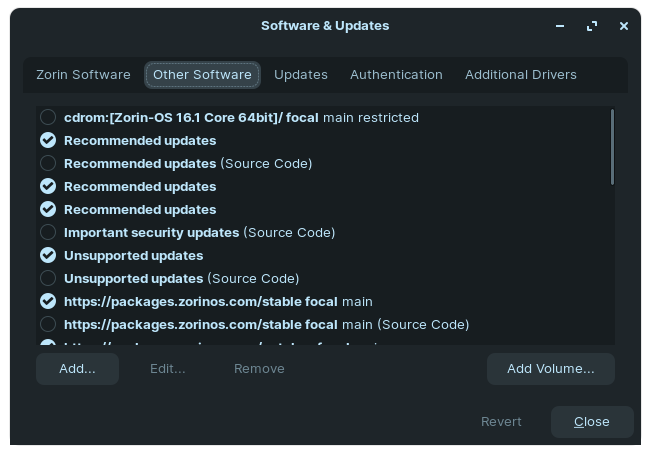

Under "Other Software"
Is CDROM: Zorin unchecked?
Yes. it is UNchecked

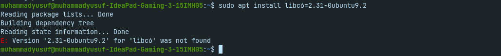

Ok... I still think it is the libc6 version... let's get risky.
sudo apt install libc6=2.31-0ubuntu9.2
This will want to REMOVE a bunch of packages like:
build-essential will be removed
g++ will be removed
Please post that output here.
WHAAAAT??? I'm totally confused
That makes two of us...
That should be the focal package...
