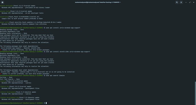

I am sorry for all this trouble. This is very frustrating.
Let's try:
sudo apt clean && sudo apt autoremove
sudo apt install lib32z1 && sudo apt update && sudo apt upgrade
sudo apt install zorin-windows-app-support
It is not showing on mine, either. I just checked.
Yet, I can install zorin-windows-app-support no problem...
In Software & Updates on the "Updates" tab:
are "important" and "recommended" updates both checked to "On"?
If they are not, check them to on... then run sudo apt update
and then try installing zorin windows app support... again...
All of them are checked
I am stumped.

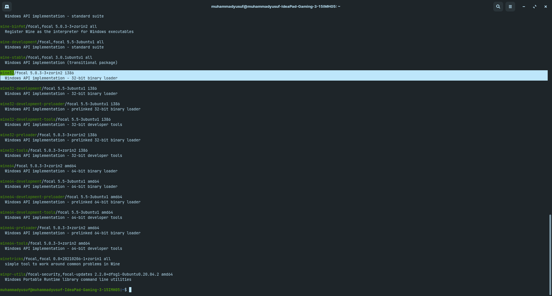

Turning to the web, I found a post that may show the problem:
https://bugs.launchpad.net/ubuntu/+source/glibc/+bug/1926918
Downgrading the dependent packages:
sudo apt install libc-bin=2.31-0ubuntu9.2 libc6:amd64=2.31-0ubuntu9.2 libc6:i386=2.31-0ubuntu9.2 libc6-dbg:amd64=2.31-0ubuntu9.2 locales=2.31-0ubuntu9.2
Should cause the package versions to match:
sudo apt update && sudo apt install zorin-windows-app-support

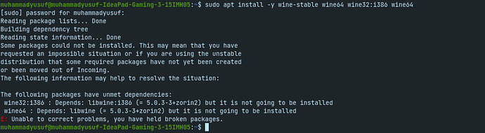

I can install it without any issues.
You added 32bit arch support already.
I am stumped...
If it is essential you need Windows apps and you can't get Wine or other equivalent to work if you have a Windows disk you could install it as a virtual machine in Virtual Machine Manager. I have Windows 8.1 Pro as a VM inside of Devuan 4.0 using Virt-Manager as it is often abbreviated to, but you would I suspect need 8 Gb Machine available and allocate 4 Gb of that to the Windows VM.
Windows App support is wrapped wine.
I have read about architectures recently. I have mentioned i986 architecture too, and I am interested in why is it so. I will now test the Lite version. Maybe It will work
Zorin OS Lite has installed
But only after enabling i386 architecture and REBOOT

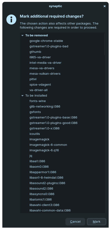

I do not trust that situation. I hope you did not proceed.
Please outline what you were installing through Synaptic.
It looks like it was trying to remove Libc6 64bit, to me. And that would be very bad if that happened.
Of course, I have canceled it. I use Synaptic only for removing.
When it comes to people and computers, I never have any idea what they will do, next.
Ok, what were you removing?
libreoffice and WPS office. Twice :). ONLY. Nothing dangerous
