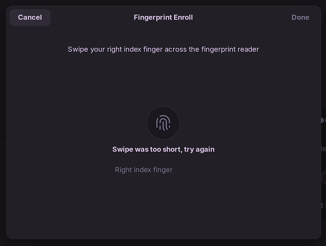

Is there any way to make the fingerprint scanner work like the Windows Hello one, where you tap to scan your fingerprint rather than swipe to scan?
My fingerprint doesn't work at all when swiping anyway - it always tells me that the swipe is too short:
I think it might be because my fingerprint button is skinny.

Hi Aravisian,
So these are the outputs for the first three commands:
joe@joe-Vivobook:~$ fprintd-list $USER
found 1 devices
Device at /net/reactivated/Fprint/Device/0
Using device /net/reactivated/Fprint/Device/0
User joe has no fingers enrolled for ElanTech Fingerprint Sensor.
joe@joe-Vivobook:~$ fprintd-delete $USER
found 1 devices
No fingerprints to delete on ElanTech Fingerprint Sensor
joe@joe-Vivobook:~$ sudo fprintd-enroll --debug
[sudo] password for joe:
couldn't parse command-line options: Unknown option --debug
joe@joe-Vivobook:~$
--debug seems to not be a real flag and when running sudo fprintd-enroll --help, there's no flag that indicates a debugging flag.
Although, I still went ahead with the rest of the commands and I broke my login unfortunately (whenever I would input my password, Zorin would say that the password is incorrect or the login screen would be stuck in a loading state).
I went into recovery mode and commented out auth required pam_permit.so with nano, and I managed to log back into my laptop. I guess It's not possible to enable fingerprint tapping, which is such a big shame :frowning:
I would appreciate if you have any other ideas, but if not, thanks a lot for looking into this!
