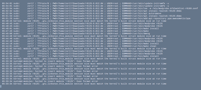

Attempted Installation of r8125 Ethernet Driver
I attempted to install the r8125 Ethernet driver by following the steps below:
Cleaned the previous installation:
Executed sudo make clean in the /home/Downloads/r8125-9.012.04 directory.
Installed the driver:
Executed sudo make install in the same directory.
Loaded the module:
Executed sudo modprobe r8125.
However, I encountered the following error:
modprobe: ERROR: could not insert 'r8125': Exec format error
module r8125: .gnu.linkonce.this_module section size must match the kernel's built struct module size at run time
Please guide this nub on how to resolve this issue.

This is normal. Many times, users will retain two or three kernels in case you need to fall back to a working kernel after an upgrade.
Have you checked all your sources and ensured that all packages are up to date?
Did you use the Zorin Upgrader tool?
Which kernel are you using and did you patch or compile the kernel or make any other customizations?
If not; I recommend getting the Realtek 8125 driver from a different source.
Admittedly, I would use the
sudo apt install r8125-dkms
command... That may be more productive than trying to build from source.
