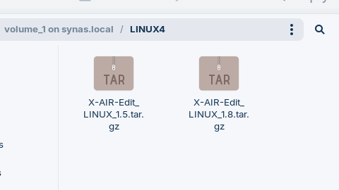

Your downloaded tar.gz file is a bit old, there is also a newer version 1.8 to download.
Could You maybe be more precise what Software for what Model You have downloaded. I take a Look at the Download Page and there is a lot Stuff for this X Air Thing.
Yeah I did also download a 1.8 firmware update. Thank you.

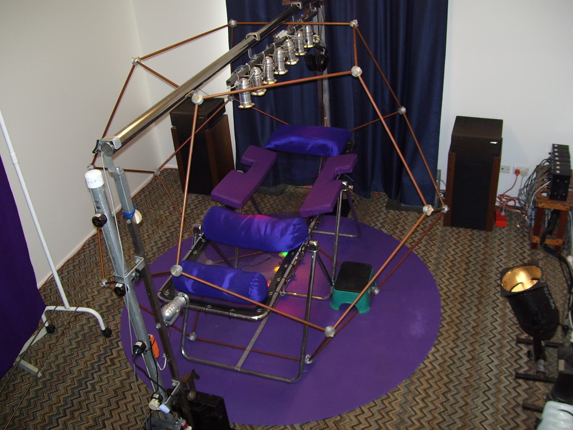

This is the esoteric enclosure I use for balancing the human body's major meridians (chakras). I use Light, Sound, Sacred Geometry (Dodecahedron copper platonic frame) and Crystals. You have micro level dodecahedrons in your DNA. The X-Air Edit sound mixer supplies audio to the large headphones and speaker boxes that have the sound technology program that clients absorb in the process. I just thought I'd throw in the pic as something different?
It is different, interesting and amazing. It led me down a rabbit hole of researching practices of cultural significance and learning about other traditional practices.
Admittedly, having studied biotechnology with UC Berkeley, I can attest that DNA does not adopt a dodecahedron structure at any recognized organizational level; whether in the double helix, chromosomal packaging, or higher-order genome structures.
What this means for the forum is that we all must avoid Medical Advise being given in this setting, which is a GnuLinux and technology discussion and troubleshooting board.
You mentioned "Clients" - which is self promotion of a business on the forum; and medical advise - which touches the Forum Guidelines. Please avoid those specific comments even as you share items of interest.
It is great that your software solutions help you in real life practice and that we can see the culmination of being helpful to your success.
