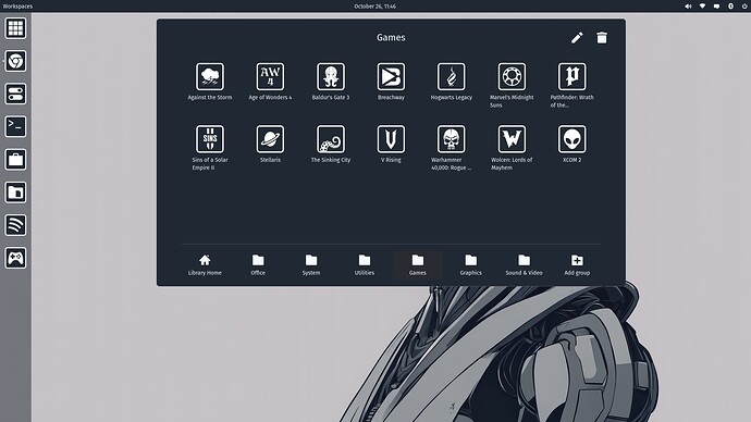

Wayland works nearly perfect with AMD cards, but Nvidia cards struggles is my experience. As I have both. I even games under Wayland now. But that's under Pop OS which has newer wayland libs.
