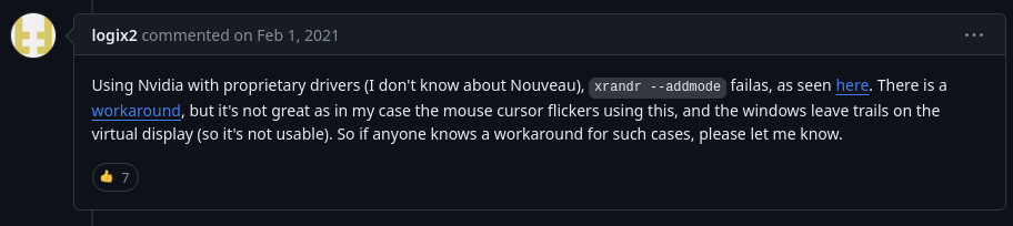

As cited in this comment, there should be a workaround to make it work on proprietary, but I'm unable to make it work.
As indicated in the solution, I should create a new configuration for the virtual monitors, but I'm having 2 problems:
