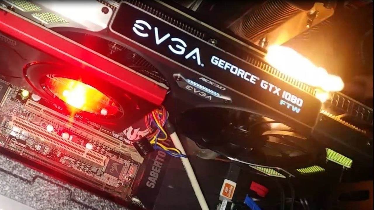

For the record, this was a joke. Although, what happened to those 3090's this year was more recent, and EVGA was like, were so sorry, let us replace your 3090's that we should have tested before leaving out the factory with a defect that spins them up to 5000 FPS, overramps the fans and VRM to +180%. Uggg
