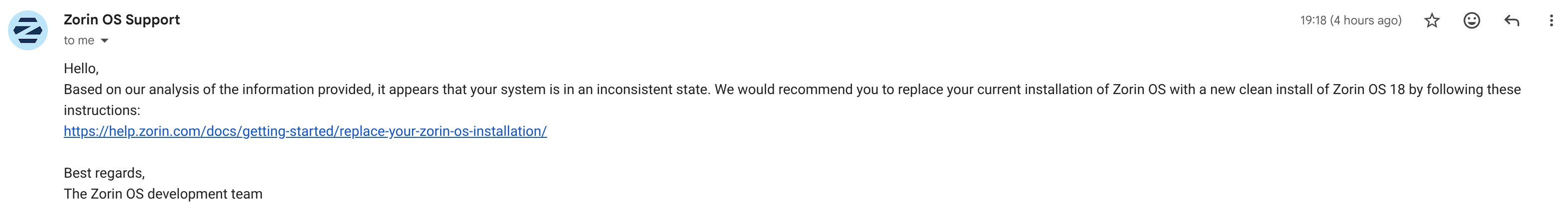

I've then raised a ticket with the Zorin Team, but they said this:
That was not an option for me, since the very purpose of upgrading was to avoid a clean installation. And given Linux's modularity, it was impossible not to find a fix that didn't involve reinstalling.
