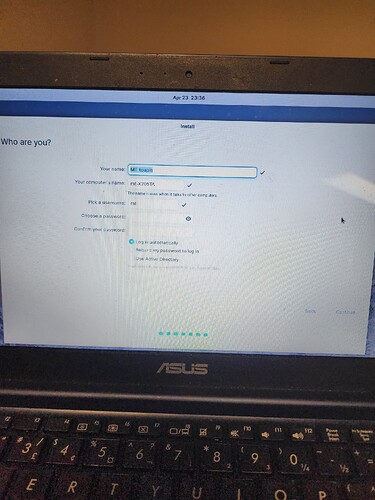

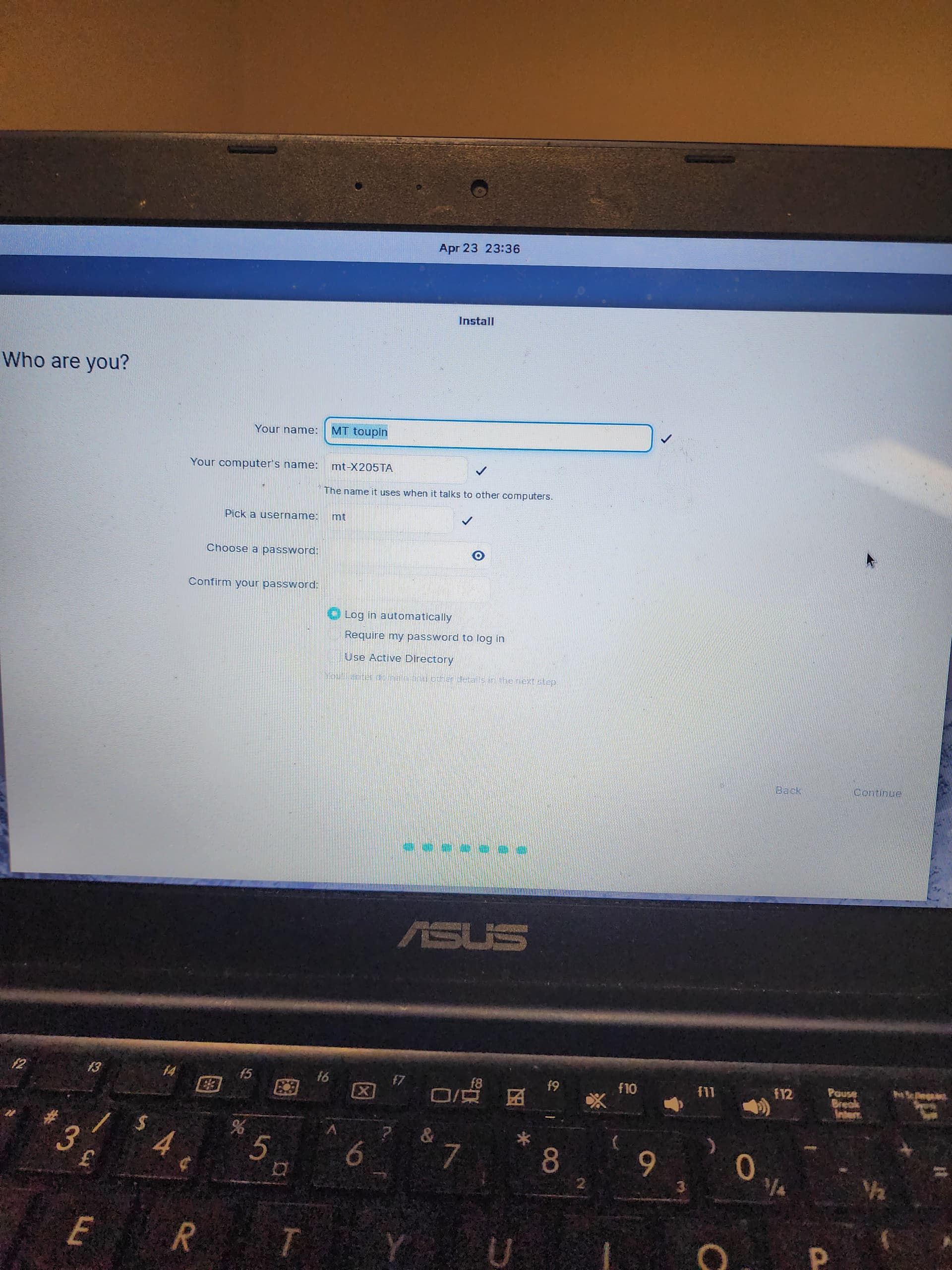

Took a while last night, then I went out of town for the day. I'm b-a-c-k now and tried to install Zorin 16.3 once more; sticking to the installation defaults.
I get to the "Who are you?" (woo hoo, woo hoo ... Sorry, channelling The Who) screen. Put in Mom's name: "MT Toupin", accept the default Computer Name: "MT-X205TA" and default User Name: "mt" .
If I input a fair password ("fiston.12" for example) the screen doesn't allow me to hit "Continue" (i.e. it's greyed out).
Same effect if I select "Log in automatically" w/o a password.
At this stage, my only way out even after waiting a lllooong time is to hit the power button- even the "three-finger salute (Ctrl-End-Del) doesn't work. That doesn't power off the tablet, but does bring the "Back" button to life and it takes me back to the "Where are you?" screen, though now it thinks I am in Newfoundland rather than Alberta (at least it still has the right country). Reset the time zone, hit "Continue", repeat whole "Who are you?" scenario described above.
So, what gives !?!?!
Thx, JT
(If we don't get it tonight, you'll not hear from me for a few days, as I will be driving home on Thurs. Bringing the infamous tablet with me because I am a glutton for punishment. jt) Man, I wish I knew what I was doing!!!
A screenshot might help. You might be giving your attention to the password, but there likely is something else there that needs an entry that you are missing.
Ah! Another challenge.
Hopefully this is legible....
