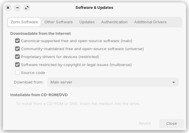

Hello,
The below warning lines appears after shifting update repository from (say US the default set during installation) to Main Server.
Screenshot from 2024-01-29 19-48-40

Please advice, Shall that duplicates removed manually?
Yes, you can comment out or remove the duplicates.
I had that too and I made it so:
Open the Terminal and type: sudo nano /etc/apt/sources.list
Then You go to Line 5 and Line 26 and make a # at the Beginning of the Line. When You made that press ctrl+o to save it, then press Enter to confirm and then press ctrl+x to close it.
After that makte sudo apt update && sudo apt upgrade

Regional Server or Main Server:
When a user installs a GnuLinux Distro, it often will automatically link them to their local Regional Server.
This allows that the local server may provide a better connection and faster speeds.
According to the maintainers, there should be no difference between the regional servers and the main server. All regional servers get their packages from the main server.
Some say that switching to the main server can put too much strain on the main server.
However, the Main Server is robust with redundancies and multiple mirrors. It can handle a substantial strain. The Main Server is what supplies the regional servers. There is no reason to believe that the Main Server cannot handle the load; In fact it can handle far more than the current traffic.
And often, we have noticed users running into installation and dependency issues due to their local regional server failing to have the correct packages and dependencies. While this is stated to not supposed to happen; it most certainly does happen. It happens most often when the maintainer of a regional server is not actively monitoring and correcting issues. It can also happen due to packet loss or poor connection.
Switching to the Main Server is a viable means that a user can get packages and files directly from the source, though it may be slightly slower.
