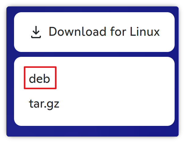

For Discord: Discord offers a .deb Version what You can download. Then You don't have to fiddle with Flatseal.

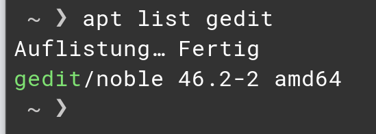

Ah, did Gnome deprecate Gedit? I had to look this up.
GNOME Text Editor replaces gedit as GNOME's default text editor, and was created due to the GNOME developers' intention of having all of their programs comply with the GNOME Human interface guidelines (HIG).[5] The adherence to their HIG is done by using the libadwaita library
GNOME Text Editor - Wikipedia.
Oh, I see. Microsoft Force.
But Gedit can still be installed if prefered. But it isn't longer the default Text Editor. It is available:
