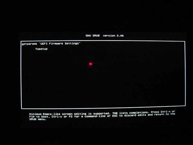

Also of interest I noticed two more options in the Zorin boot Menu and though I didn't type any commands I opened each to see what they say.
