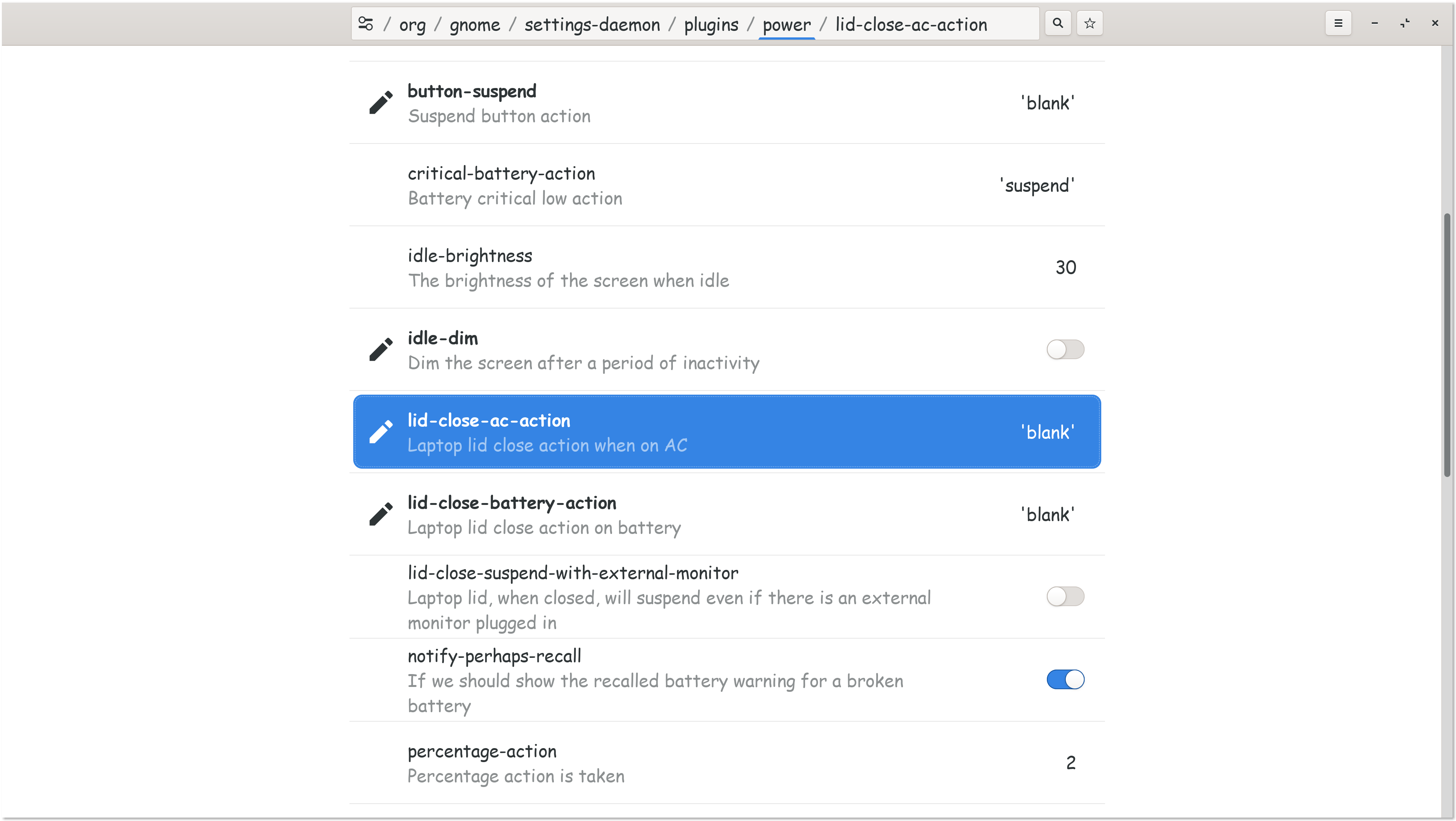

So, You have a Laptop. You could try this:
Unfortunately the problem returned. Both suspend, and just closing the lid, again caused the system to crash.

Suspend mode causes problems on some devices in Linux. If the problem occurs again, you could try to disable the automatic suspend mode and only switch to suspend mode via the button in the start menu and see if that helps.
