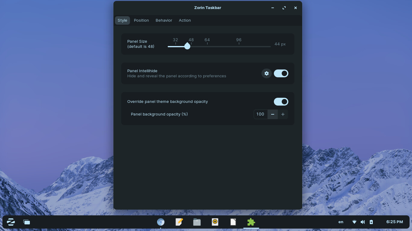

Which layout are you using? Do you have any other gnome-extensions? Can you also give me some system information. Maybe give a pic of your layout if you don't mind.
If you wonder why I center my applications:
I center them because while using Windows 11, I got used to dragging my mouse to the bottom but I still can't use the start menu at the center so this layout stuck.
Yes the intellihide. I am using default layout, disabled taskbar and enabled zorin dash. I thought that too was the issue so I tried other layouts with docks and had the same issue. The same issue happens with dash to dock too.
