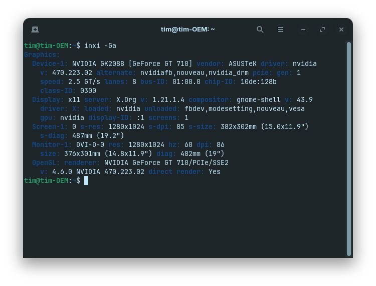

We need some more info:
sudo apt install inxi
inxi -Ga
Try switch to Open Driver (nouveau), and see if ot helps. It might be a driver glitch as v.470 is old.
Doesn't boot when the nouvea driver is used. Beside the Nvidia driver was only updated October 23. Is there a way to make the Nouveau drivers boot without recovery?
Well mr storm was spot on Help now works with Nouvaeu driver but when I changed over I lost my boot files so had to use Boot repair from the Live DVD of 16. All seems good now.
Spoke too soon the boot freezes at the Z logo with a couple of stray lines how do I solve the boot problem?
