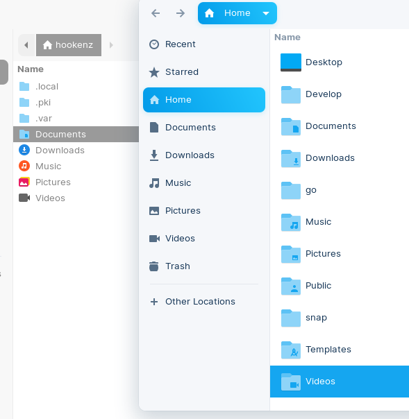

I've been using ZorinOS for about 2 weeks and I've found an annoying problem. It's generally very good other than this.
I use it as my work PC and we use Slack and Zoom. I've noticed that for example in Slack if you go to upload a file, much the home directory is hidden. For example, my "develop" directory does not show. It only shows Documents, Downloads, Music, Pictures and Videos and no other folders. I tried the "+ Other locations" option but develop is hidden as well as other folders.
In Zoom, I tried to add a background image but had a similar problem. In fact, no jpg files could be found. It's like the dialog box is crippled. The normal directory browser shows everything. Where is the magic setting that turns off this broken functionality?
While CTRL+H did actually show hidden dot files. It still failed to show the other directories which aren't hidden in the normal sense. It seems to be being filtered. Any ideas?
The dialog on the left is the filtered view after CTRL+H. The right view is the full list of whats in it. As you can see, some directories are not even showing.
When I installed Slack and Zoom the Software Centre prompted me to install it from there which uses flatpak images.
It seems that's the issue. I installed an app called flatseal - an app that allows users to manage flatpak app permissions. This allowed me to widen the permissions to all user files. Problem solved!
