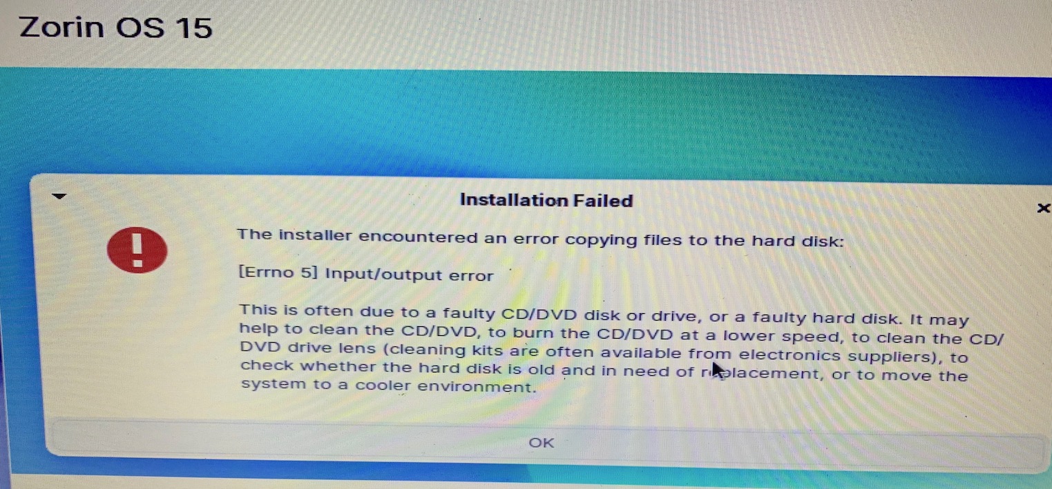

@Aravisian - I have a screenshot of the error I got [Errno 5] Input/output error
It’s later in the process when the installer is actually trying to write to the new, blank SSD. {image attached}
Might be a good idea to check the partitions on that new SSD with GParted.
formatted the SSD with ext4 and checked it with GParted - no errors

jp42, have you performed a memtest? You can do so from the grub menu.
Please check that UEFI is set to AHCI and not set to RAID.
Some get this error when using the balenaetcher to USB option. I always prefer to burn to a DVD disk to install. Set the speed low when burning to a disk. Fast burn or USB install can both throw errors with the medium or the input output.
Finally, ensure that your bootloader partition is on the same disk as your installation.
I posted the prep you need to do with an SSD drive in my first post (prep’ing Samsung SSD before install with commands needed for it to take.) You should also format to Ext2 as Ext3 and Ext4 are jounaling systems that will shorten the life of the SSD. And you have to setup TRIM - only Windows does that automatically.

The odd thing about the USB installer created by balenaetcher is that it did work to install Zorin 12.4 onto the old original HDD? I am going to follow the advice of @swarfendor437 and do the prep on the SSD that I missed before…
