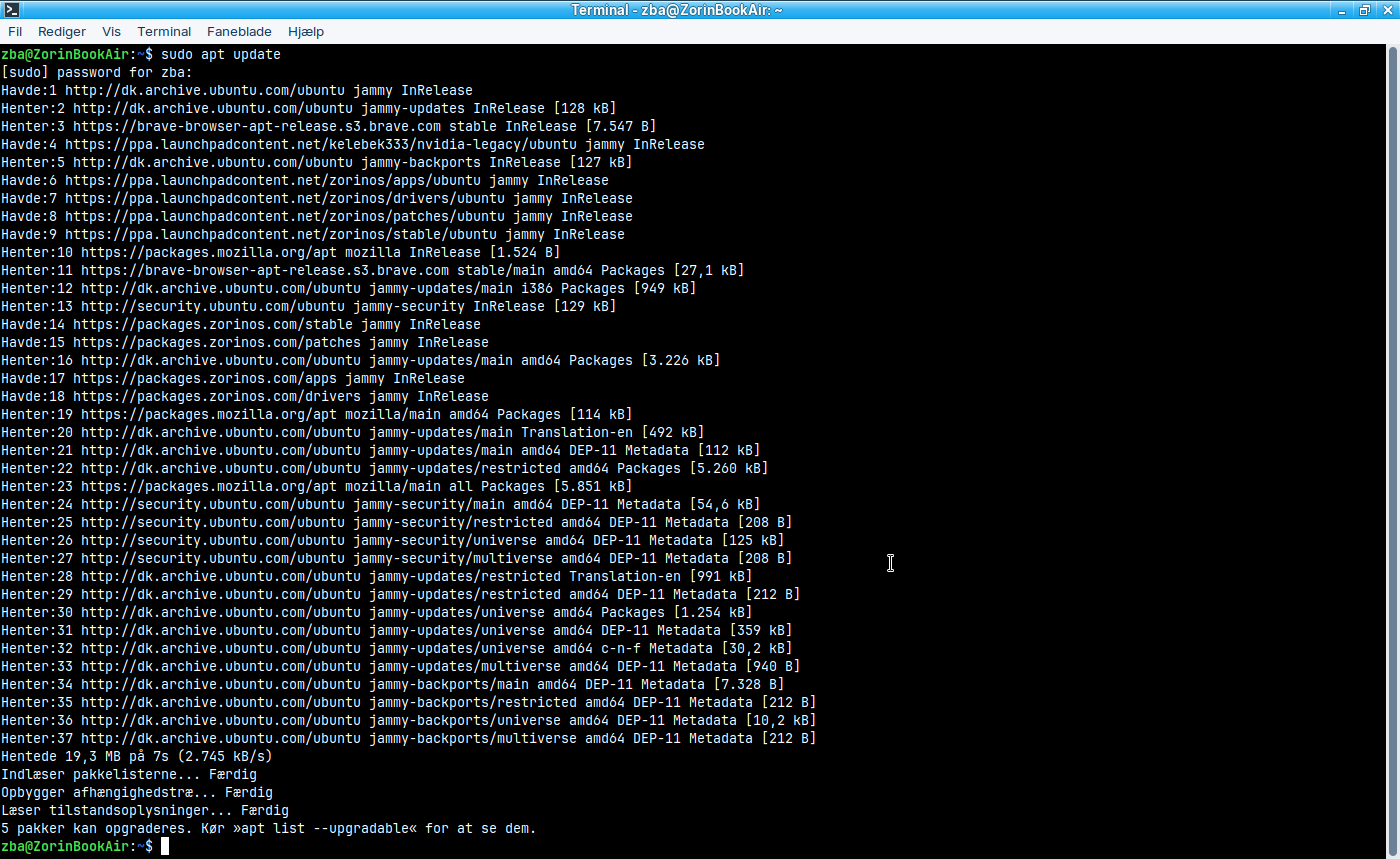

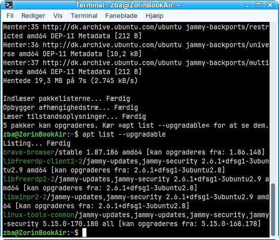

Can You make a sudo apt update and post the Output here please?
The kelebek333 ppa is added, but something seems to be wrong with this driver package. I found a thread from 2024, there was shown the same error:

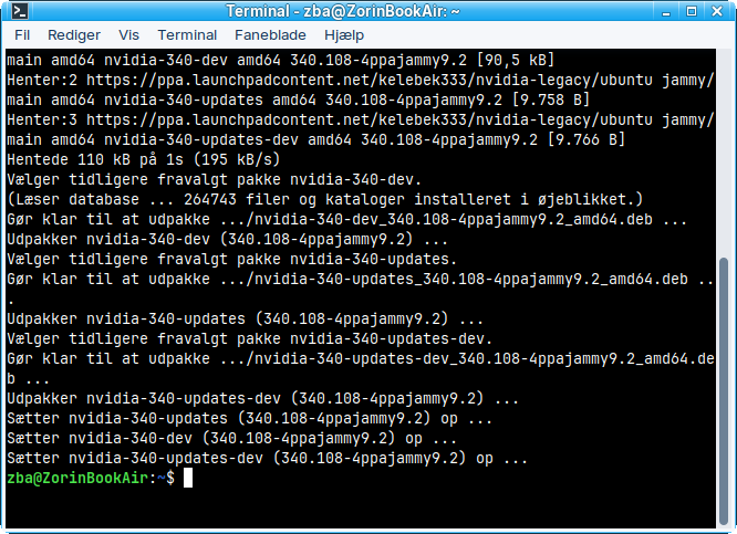

I found also threads where another command is used to install the 340 nvidia drivers from the kelebek333 ppa. You could try it with
sudo apt install nvidia-340-updates nvidia-340-updates-dev xorg-modulepath-fix

this one I think did go through :smiley:
but when running this one again after
sudo apt update && sudo apt install nvidia-graphics-drivers-340
it still ends up at the end with the E: error not finding 340 packages
You don't need this command. The other one looks good, I think.
Now reboot.

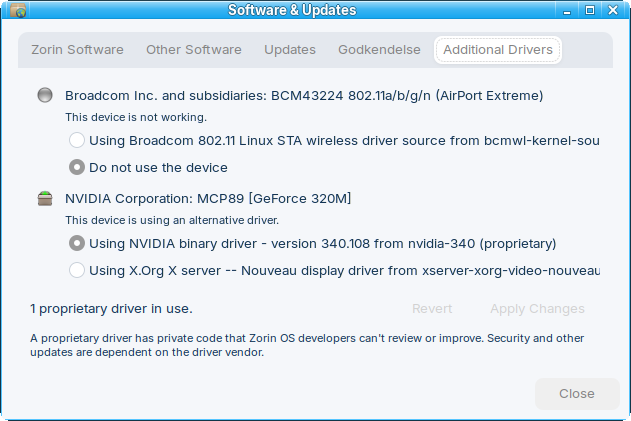

software and updates says I'm using nvidia driver - but terminal does not
Yes, and I did this last night, but was baffled by what I was seeing.
Yes, the updates and other peripheral packages are listed with .debs, but the entire driver collection needs to be; it isn't.
I am not sure what is going on there - We used to use this solution and it worked. Now, it does not.
As you point out in listing that other thread.

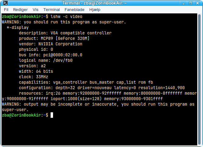

Is the proprietary driver now running or nouveau?
Currently, the user is falling back to minimal Nouveau driver.
in terminal it says nouveau but "software and updates" says nvidia
Software & Updates is not going by kernel probing, as the terminal relays. Instead, it assumes the driver in use due to its installation files.
