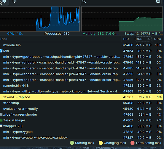

Not quite sure where to put this so put it in feedback. Been monitoring swap size with task manager. Swap drive is filling up every day with unused memory. Only use a browser (Min) once or twice a day, swappiness is set to 10 and I have 4gb RAM, 3gb of which is available to the OS.
The only way to empty the swap drive is swapoff or log out. Should the swap drive manage itself better? Thoughts?

Can you return screenshots of your system monitor? Sort by most RAM usage first.
