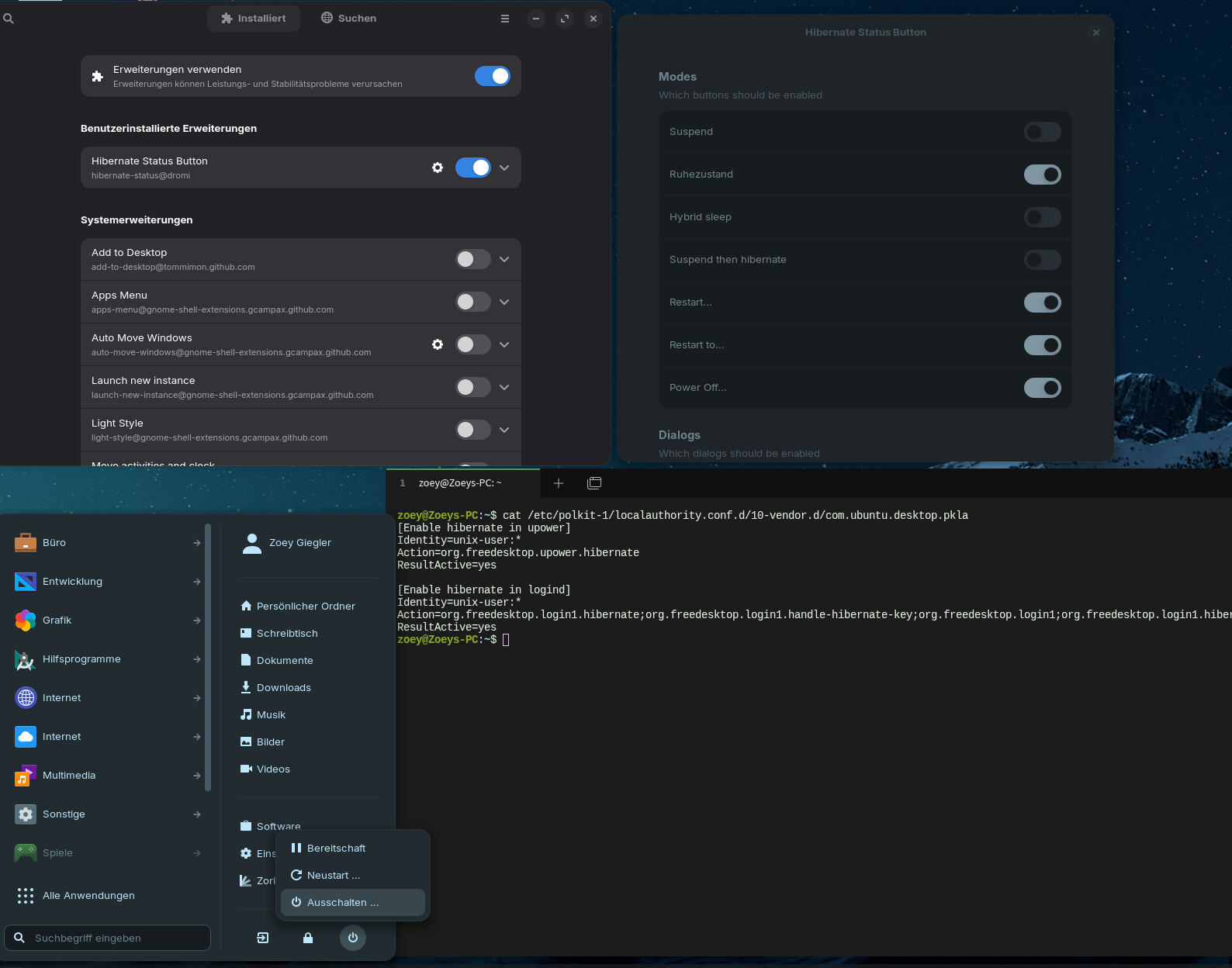

But that works for me for now, just have to debug why the button for hibernate doesn't appear after installing it. I can disable the other ones in the extension settings but enabling hibernate doesn't make the option appear
So, the Gnome extension doesn't work? Did You take a Look at the Github Page for this:

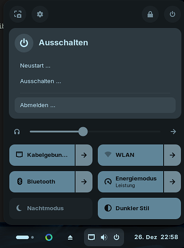

Yes, the file exists and has the entry from the github page. Extension is loaded as you can see and suspend deactivated and hibernate activated. Suspend is missing from the right context menu (still exists in the start menu) but hibernate is not showing in any of those 2
For those finding it later the polkit policy in the main github page is too old and doesn't work anymore. You have to use this one: Extension not working in Ubuntu 19.10 · Issue #41 · arelange/gnome-shell-extension-hibernate-status · GitHub
