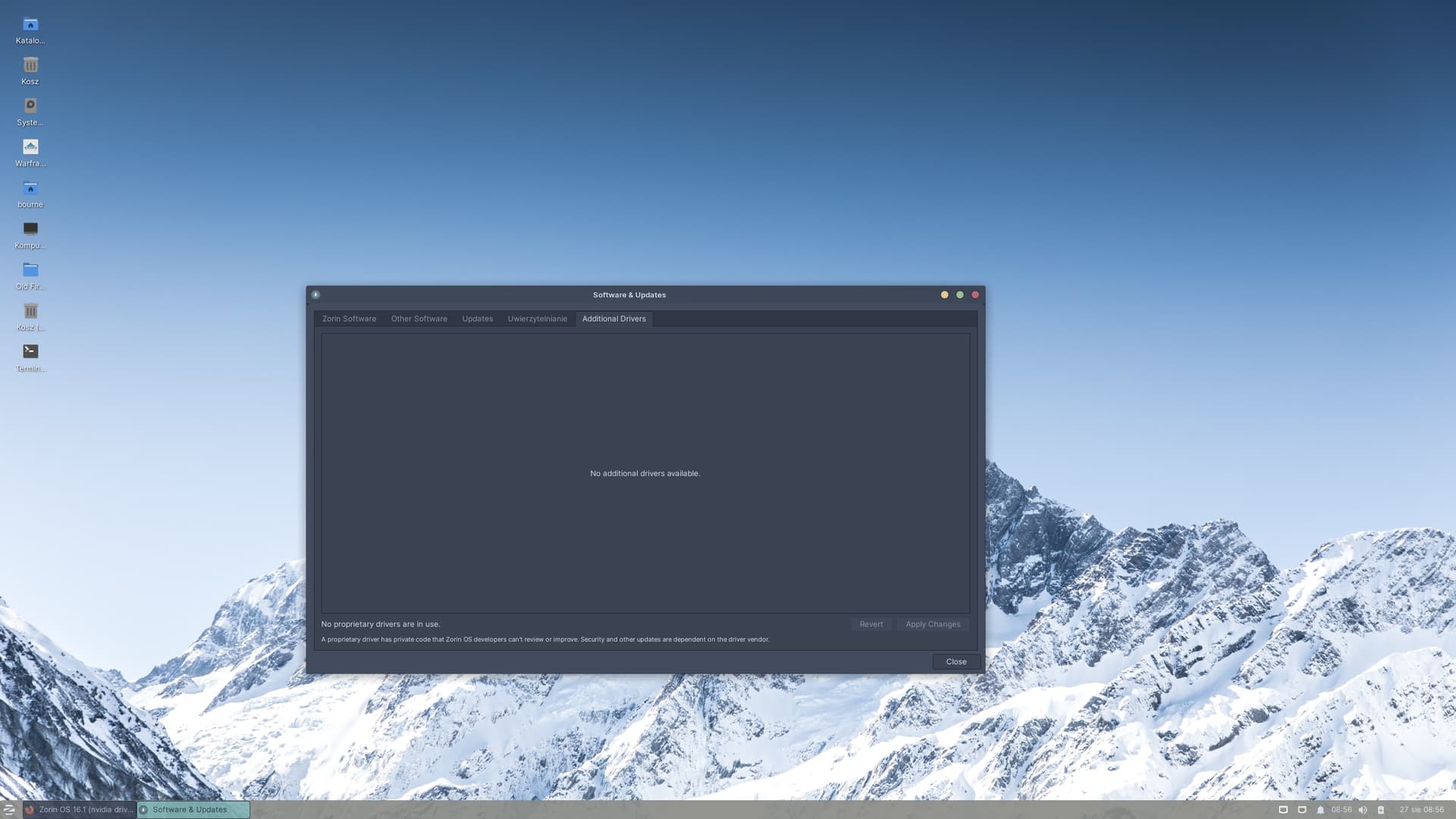

Yes. But why both not on top higher numbers. I will trying the not tested drivers.
Today I tried your suggestion and discovered this.

i don't understable yesterday was more drivers?
I missing something?
Tried installing under that drivers and have a info all time applying changes.
Weird. How this could working.
So i logout and then my desktop photo changed for standard wallpaper and without drivers.
