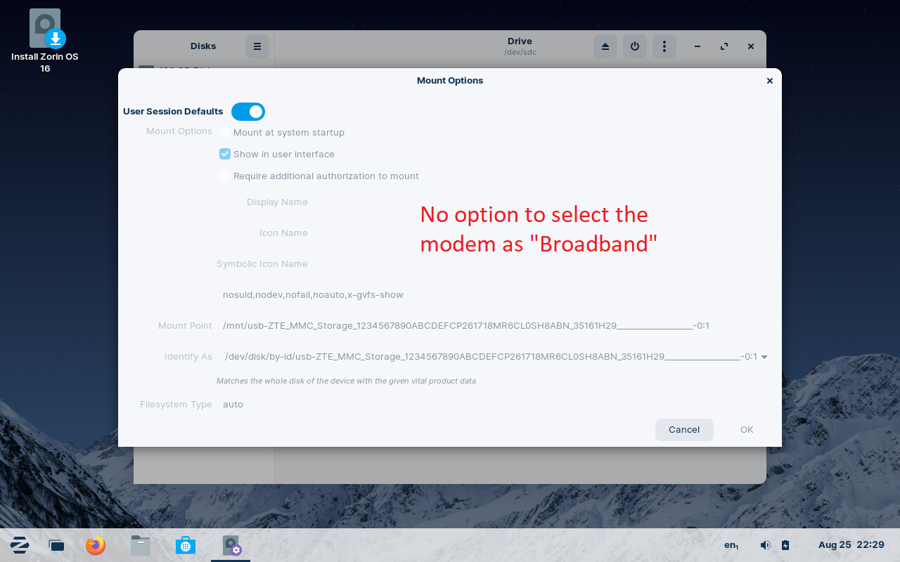

Sorry @Aravisian !!!
There is no option to mark the modem as "Broadband".
I have added some screenshots below, please take a look.

It's ok- we have just established that the computer is sensing the modem as Mass Storage instead of as a Modem, though. So now we know what to fix.
You may need modeswtich:
sudo apt-get install usb-modeswitch
This is because you need to change the mode for the USB device (modem) to modem instead of storage.
