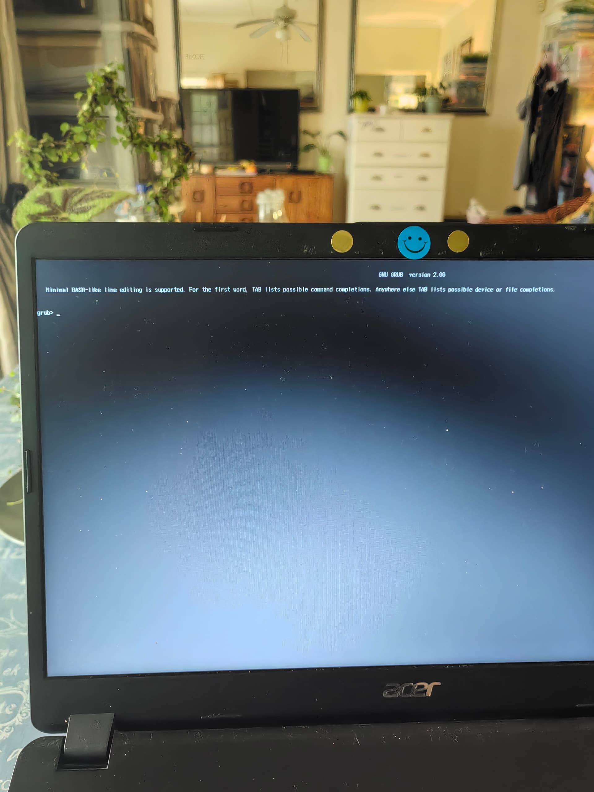

I attempted to proceed from the last screen above (Boot Error Fix) I made no changes.

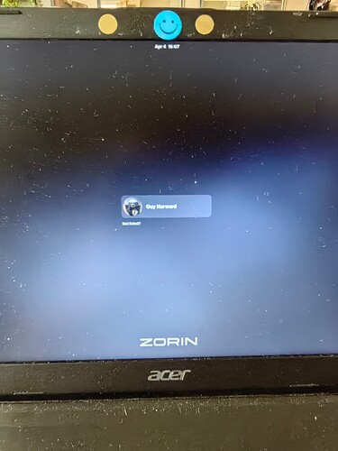

Shutdown my PC. Started PC. Proceeded to Zorin OS live (as it was before the boot error). Landed on a screen that I have never seen before asking me to Login. What do I do here? (see attached screenshot)
Please advise.
New screenshot. Please advise.
That is asking you to input those commands into the terminal, and executing them before clicking Forward in that window. That window they show may show up, and they're just saying to click yes if it does show up (using tab and enter keys). After those are done, you could then click forward to continue with boot-repair.

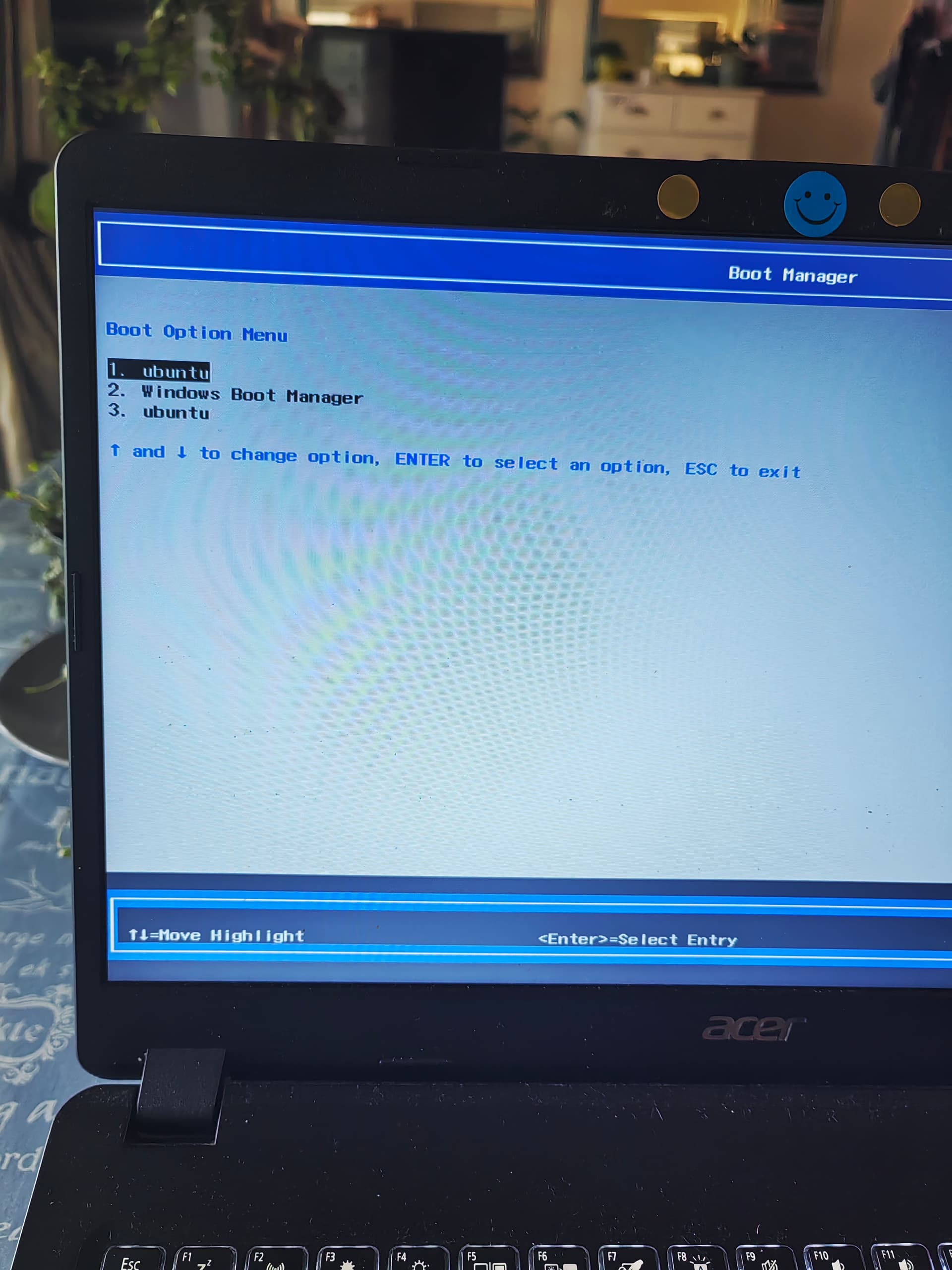

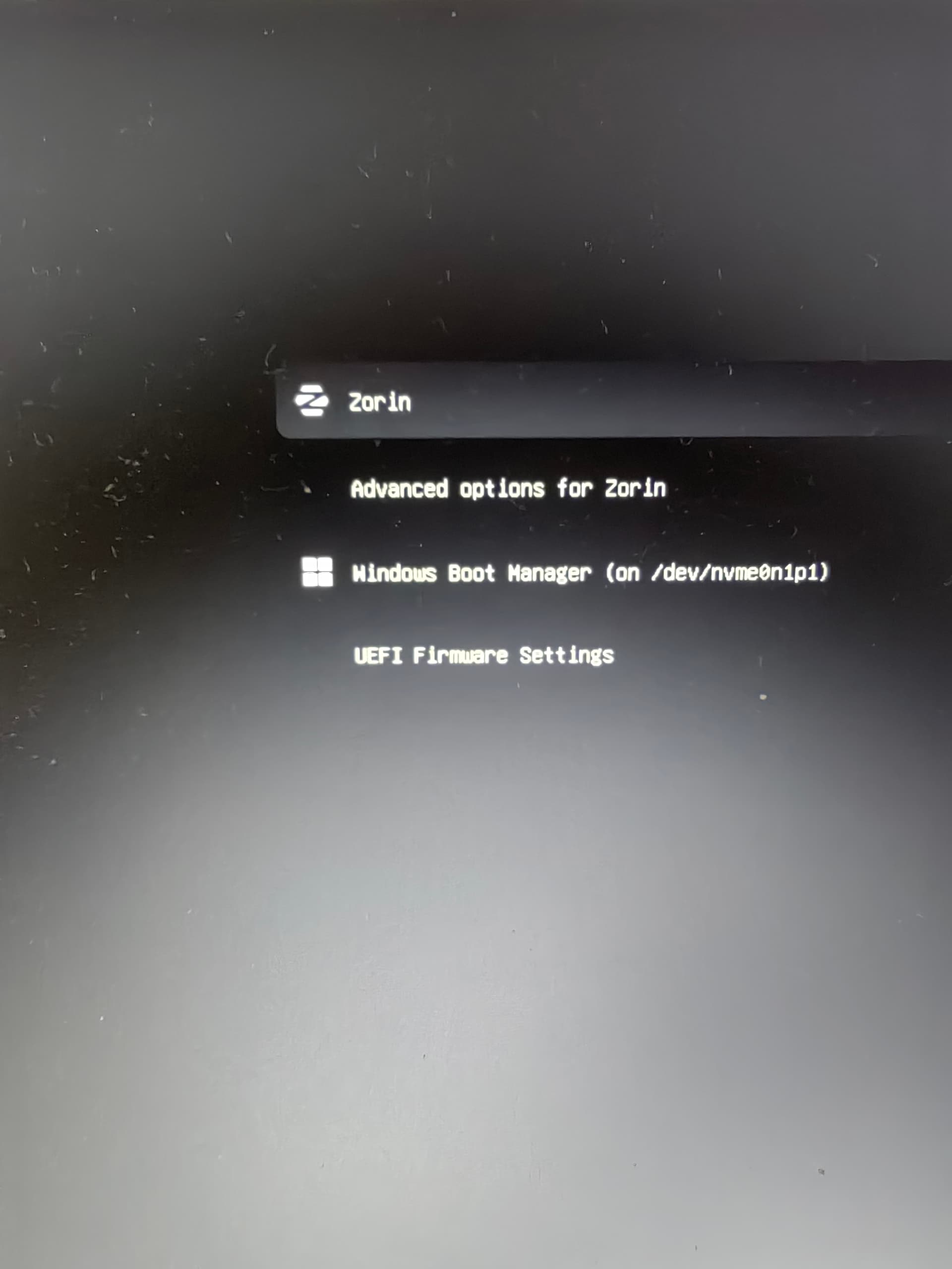

It is a mystery to me......HOW? At last I am able to boot into ZORIN as it was before I had the boot error!!!!!!!!!!!! But Boot Manager has two Unbuntu selections 1 & 3????

  1. Boot selection 1 Ubuntu
  2. Dual boot selection Zorin OS
  3. Zorin OS Login Screen
  4. Boot selection 3 Ubuntu
  5. GNU GRUB Screen
Please advise how to remove Ubuntu selection 3 from the Boot Manager.
When you are sure that the third one ist the one you don't need anymore, you can select it, then press ENTER and there should be an option to remove/delete it.
Then it appears no longer in the boot options.
Additionally you can remove the entry in the EFI partition.
