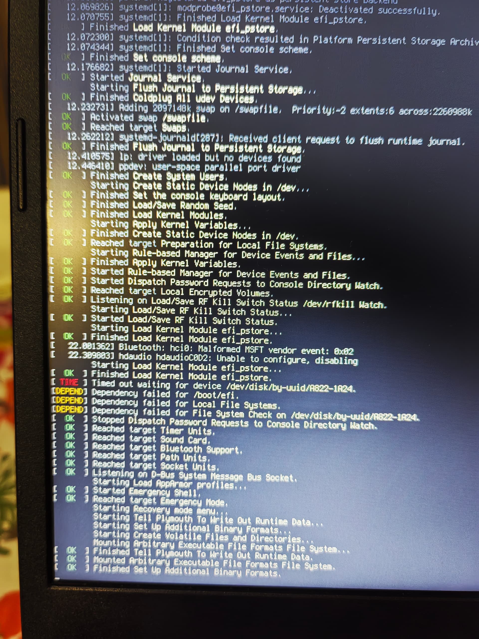

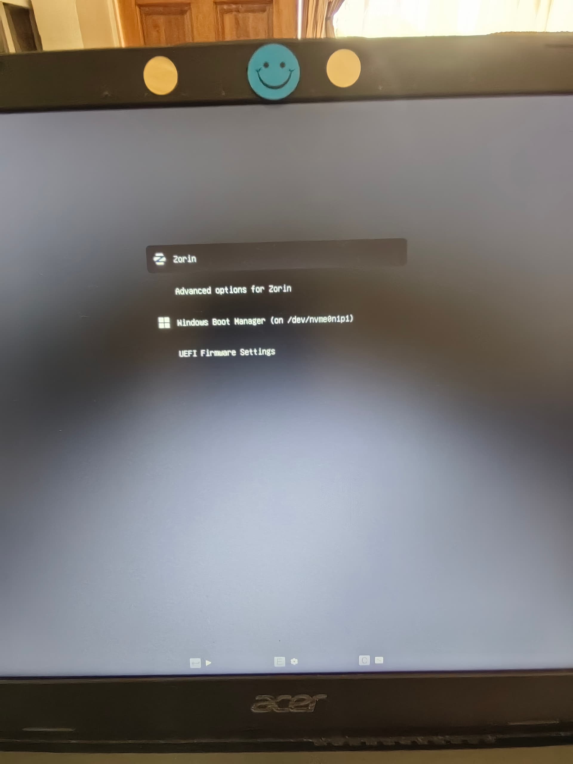

Before this boot system error I had dual boot set-up on my Notebook.
Windows 11 - SSD Drive
Zorin OS 17.2 - Spindle Drive
The dual boot system worked well between the two OS.

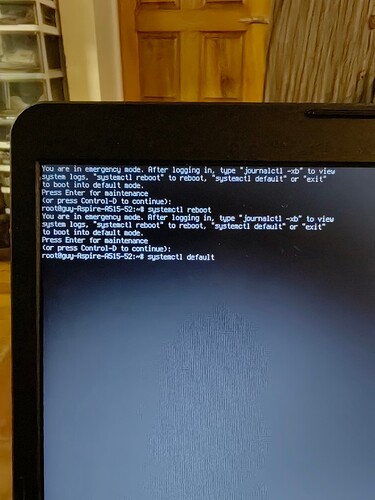

After the Boot system error. (see attachment 1)
Could boot into Windows OS with F12 with no problem.
Could NOT boot into Zorin OS - boot system error appears

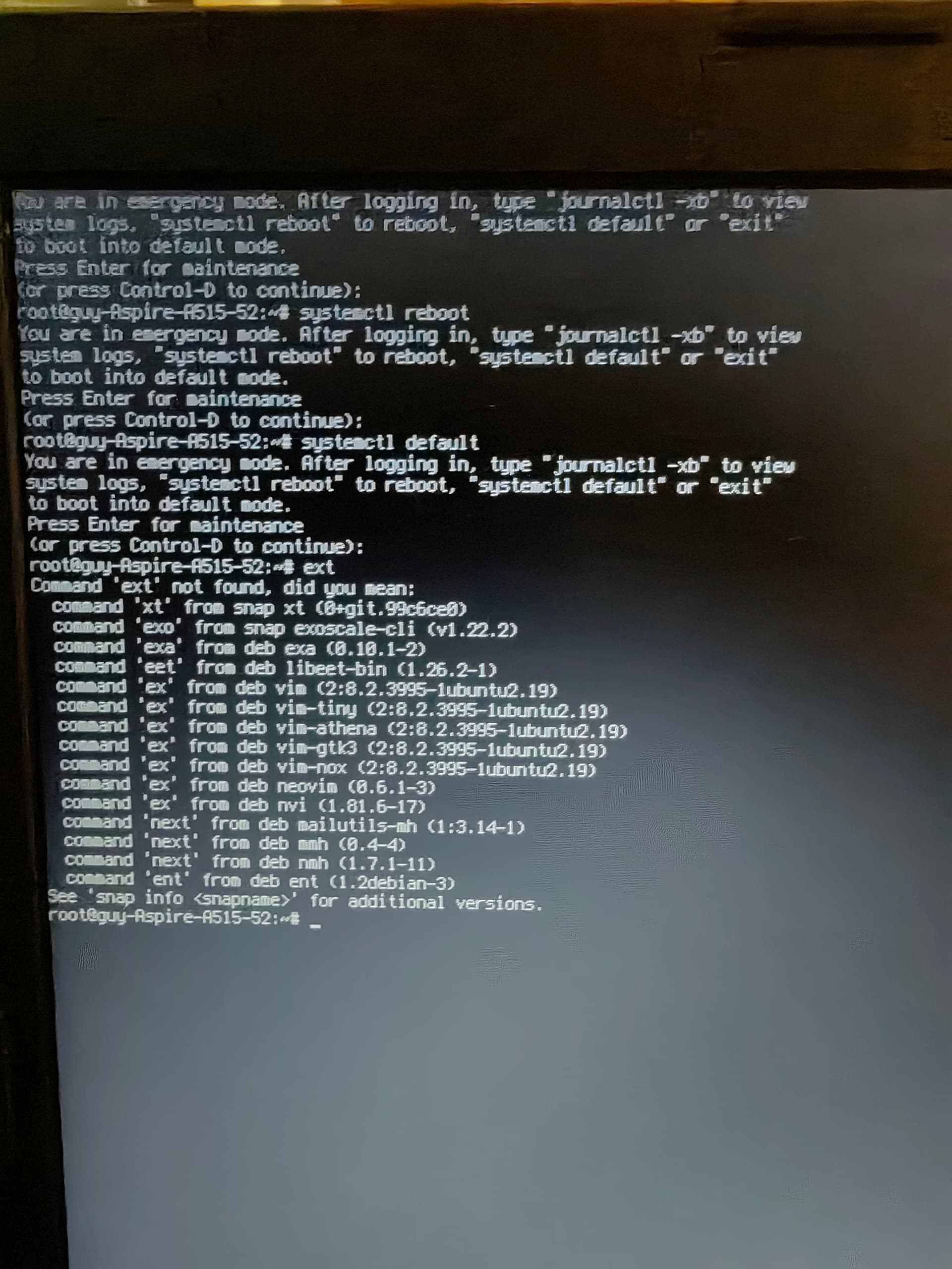

With Aravisian (this forum) assistance I followed the System Recovery process (see attachments 2-6) could not access Zorin OS due to a Windows update.

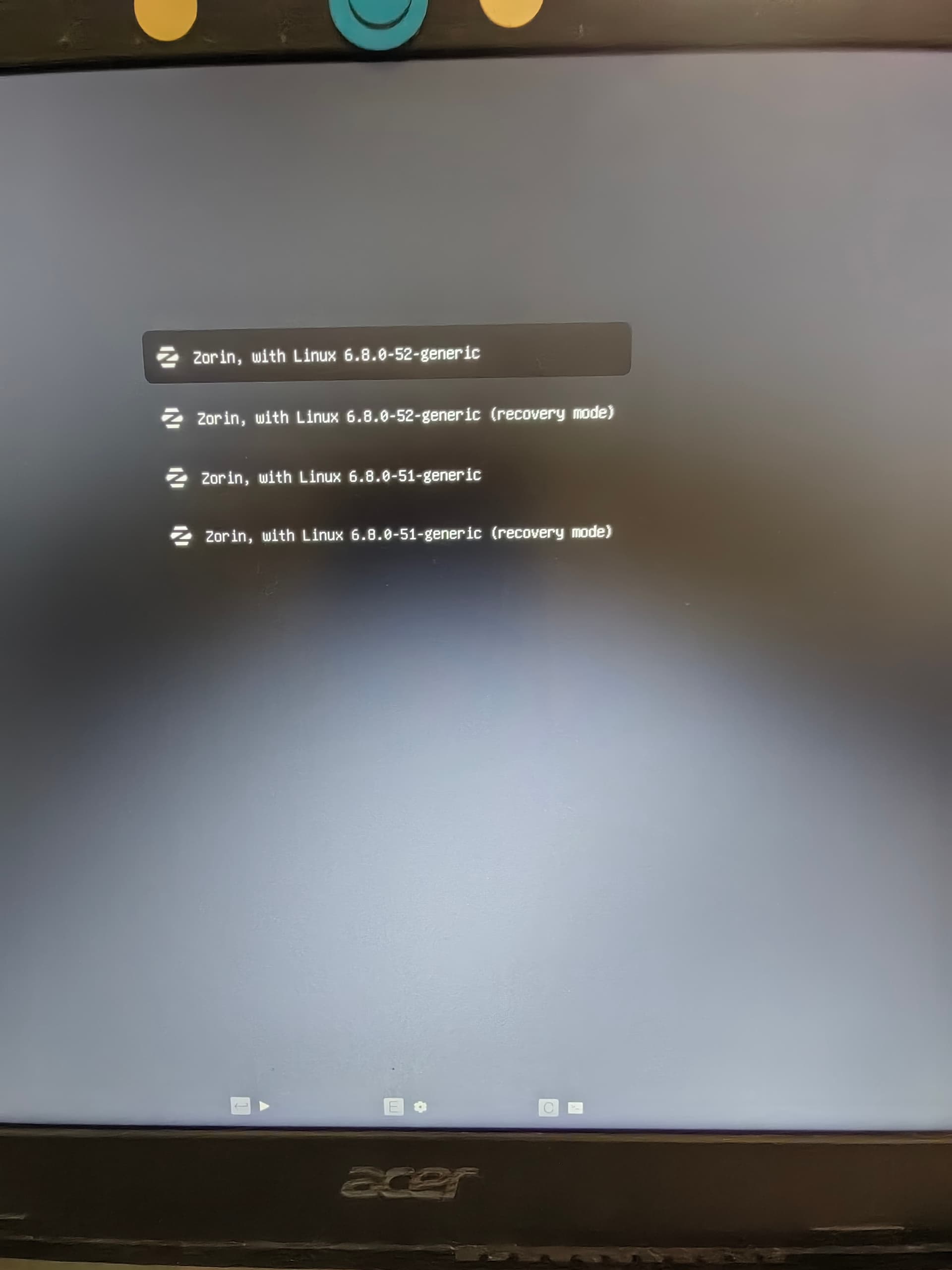

I notice you have an earlier kernel in Zorin Menu. Does it boot with that?

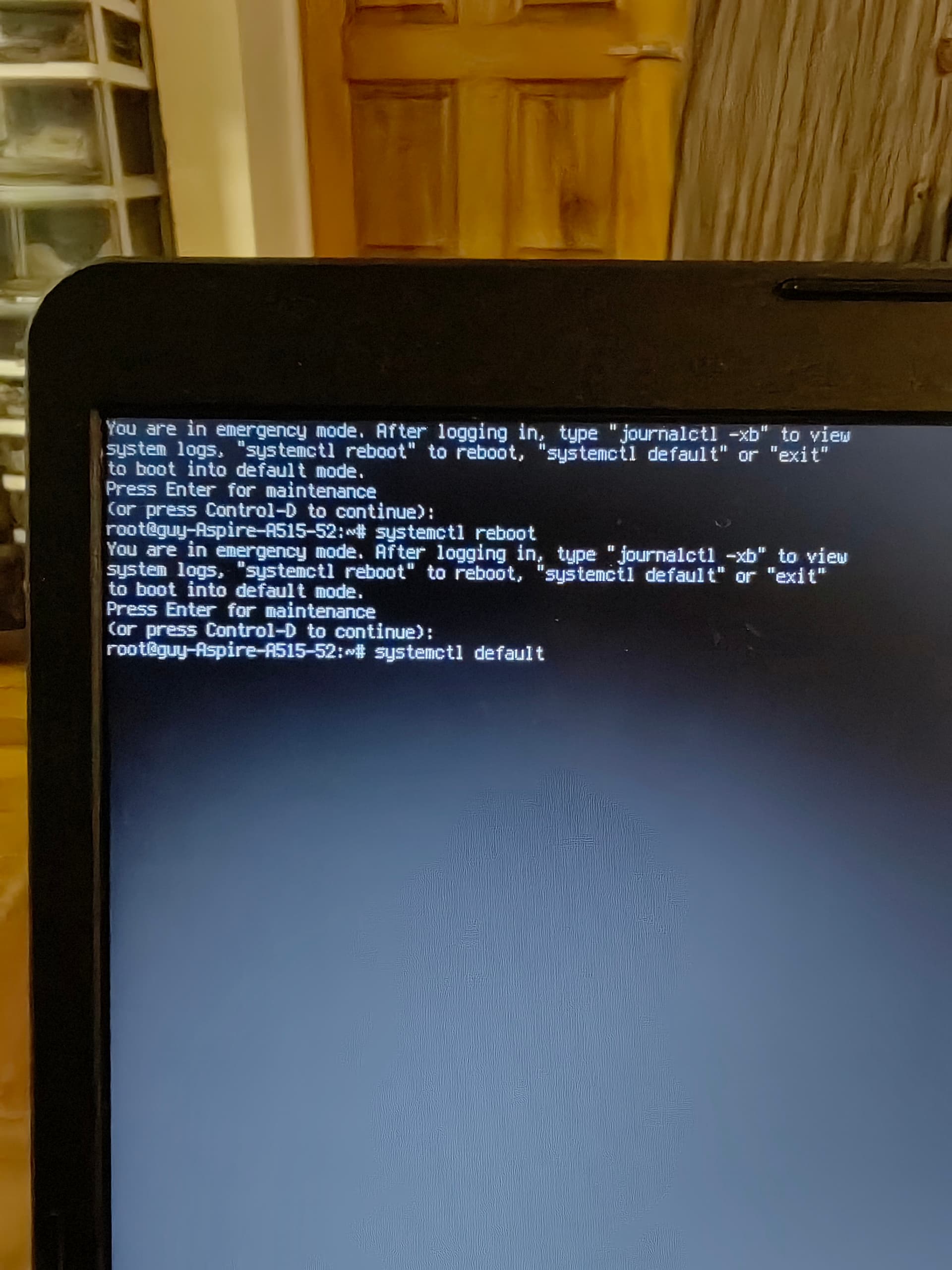

Did You tried it with the systemctl reboot Command or the systemctl default Command like shown in Your first Picture?
Thanks for your response. I will give it a try and let you know.
Thanks for your response. I will try and let you know.

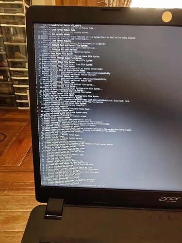

Could not boot with the earlier kernel. See attached screenshot.
Please advise further.
Tried all the system suggested commands. Notice on the last screenshot
some highlighted lines.

Same result cannot boot (see attached screenshot)

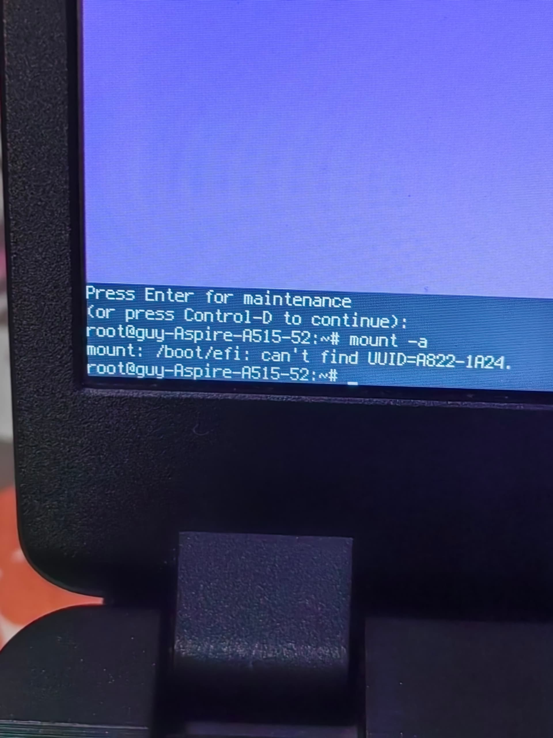

"Cant find UUID"
This looks like it is not finding your EFI boot partition.
A recent Windows Update possibly can cause this...
Have you tried Grub Repair or reinstalling grub using the instructions and links I previously supplied to your PM?
On the previous slide the command "mount -a" could not be processed due the Red and Yellow highlighted process lines error messages.
Thanks for your response. No I have not tried GRUB repair.
Let me review and give it a try and let you know what happened.
