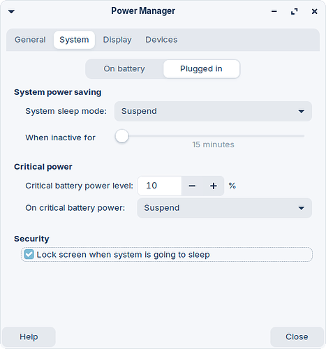

After more experimentation, I understand this:
For changes to HandleLidSwitch in "/etc/systemd/logind.conf" to have any effects, it's crucial that the boolean logind-handle-lid-switch be set to true in Xfce's Settings editor, or via command line, as shown in my reply above.
Once that is set true then the Power Manager's options for System -> "Laptop Lid" in are ignored, but other settings within that manager, in particular Security -> "Lock screen when system is going to sleep" are still in effect.
But there's no need to let logind manage the Lid switch, unless one doesn't want any of the 3 options for it in Power manager (Suspend, Lock, Switch off display)
The issue with Xfce4 Power Manager is Locking/Unlocking in conjunction with Lid opening (when the Lid is opened, unlocking doesn't show the login screen but the desktop, however it accepts login input to unlock...)
Thus, until Xfce's devs fix that notorious issue, this should work for me:
let Power Manager, not logind, manage the Lid (set logind-handle-lid-switch to FALSE/unchecked in Xfce's Settings editor, xfce4-power-manager )
don't let Power Manager lock (via the "Laptop Lid" and "Security" options in "System" tab)
When need to, always lock explicitly via Start menu or shortcut keys.
So, Super+L then close lid => when open the lid, unlocks fine regardless whether Lit was set to suspend or just to turn off the screen.

My approach above is not bullet-proof : I just experienced an instance when the setting for the Lid in Power Manager was to "Switch off Display", and logind was set to False as explained earlier, and still closing-opening the lid made the screen "frozen".
But, here's another solution that, from my initial tests, preserves auto-lock on Lid close without "freezes". UPower are the "eyes" of Xfce's power manager for Lid opening / closing. (I confirmed this in a few tests).
If you disable that by: sudo nano /etc/UPower/UPower.conf IgnoreLid=true
then after saving: sudo systemctl restart upower.service
(or reboot laptop)
then the options for "Laptop Lid" in Power Manager's "System" tab vanish.
Now if Xfce's Settings Editor option for "xfce4-power-manager" -> "logind-handle-lid-switch" are set to FALSE, then the Lid is totally ignored. (Except that, on close, the screen power still turns off, at least on my laptop.)
But if you set that to TRUE (check mark), then taken action is determined by what you have in "/etc/systemd/logind.conf" for HandleLidSwitch and friends.
(To effect changes in that file, need: sudo systemctl restart systemd-logind.service
or reboot the laptop).
The setting can be one of: "ignore", "poweroff", "reboot", "halt", "kexec", "suspend", "hibernate", "hybrid-sleep", "suspend-then-hibernate", and "lock" (see man logind.conf).
