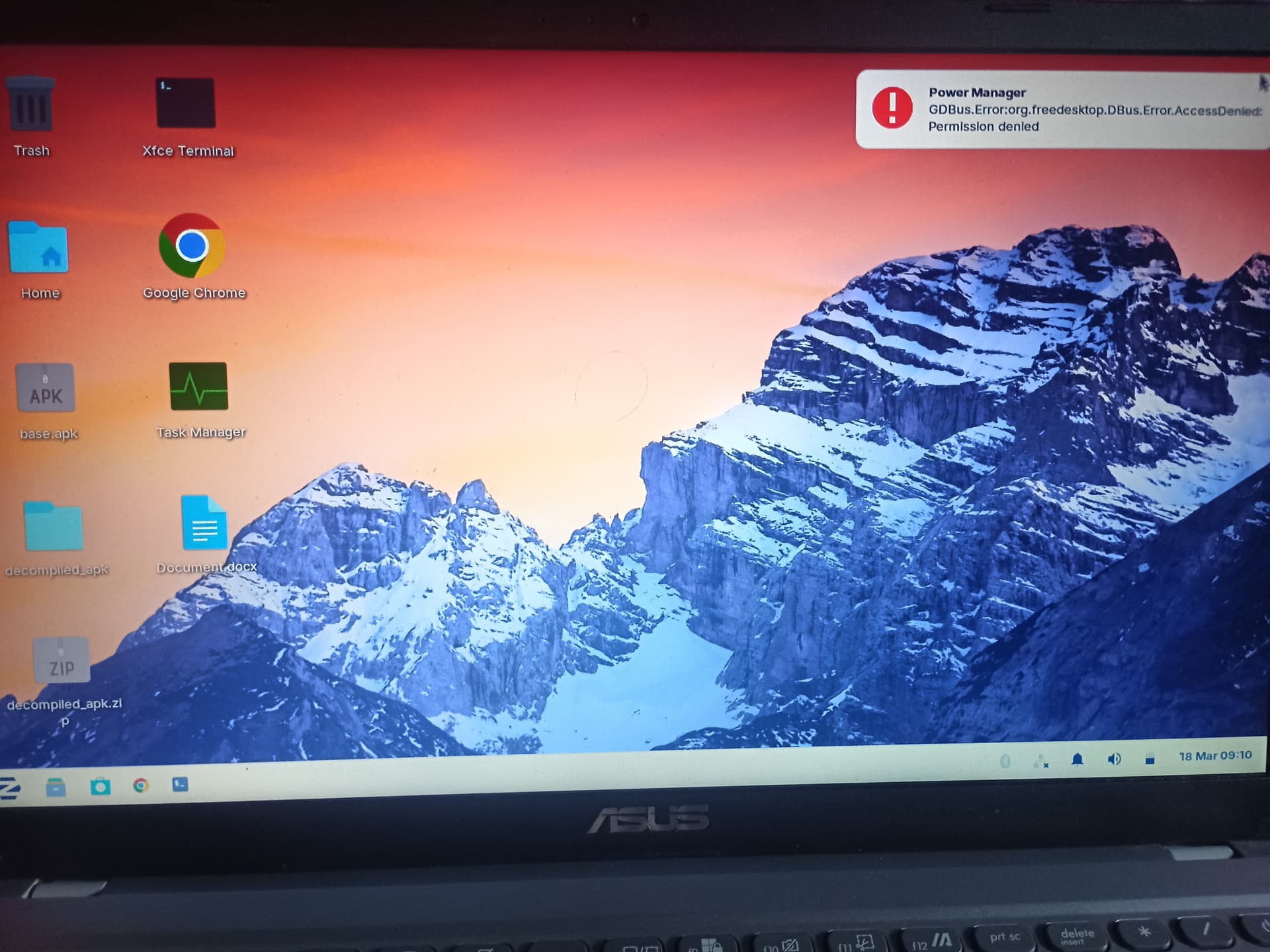

Also a new msg is showing up at the top right corner as in the image.
Yes, the power manager had its processes masked to see if that resolves the issue.
Since it did not we can unmask them

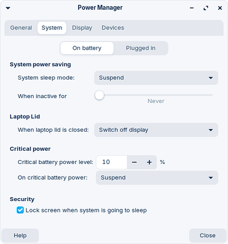

That is in the screensaver settings, which is different from Suspend.
Oh okay. That's why. Maybe we can change the way the pc handles the lid close instead of suspending the pc hould do nothing. Is there any settings for that ?
That would be a temporary solution.
In windows there is a option for this, however i am not sure for linux.

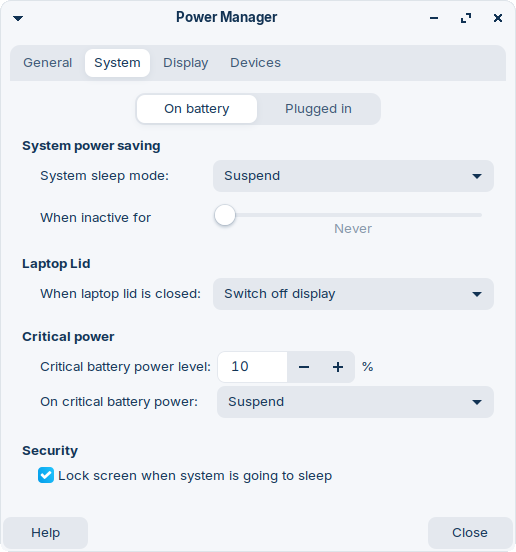

Do you have the same setting at plugged in when lid closed? Try to set switch off display here too and look if it helps.
I found this thread about this problem but it is not the same xfce version zorin uses.
I also had/still have many troubles with powersaving and screensaver in linux.
You should have this function for lidclosing in Zorin core, too. Perhaps you need gnome-tweaks for it but in tweaks there are such settings.
Yes, same settings for Plugged in.

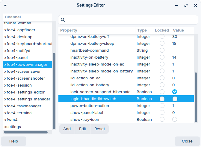

Do you mean:
xfconf-query -c xfce4-power-manager -p /xfce4-power-manager/logind-handle-lid-switch -s false
? Isn't that the same as this found in "Settings Editor" = "xfce4-settings-editor" , where it's already "False"?
EDIT: I verified it's value as shown at your link to confirm that "xfce4-settings-editor" is already in effect:
gives false
