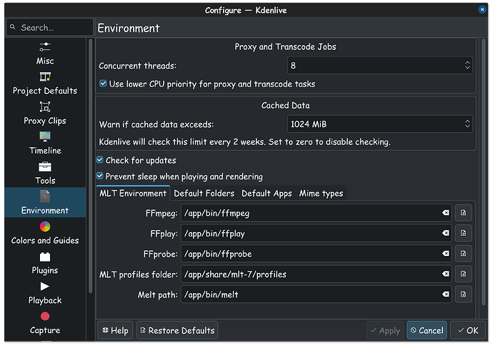

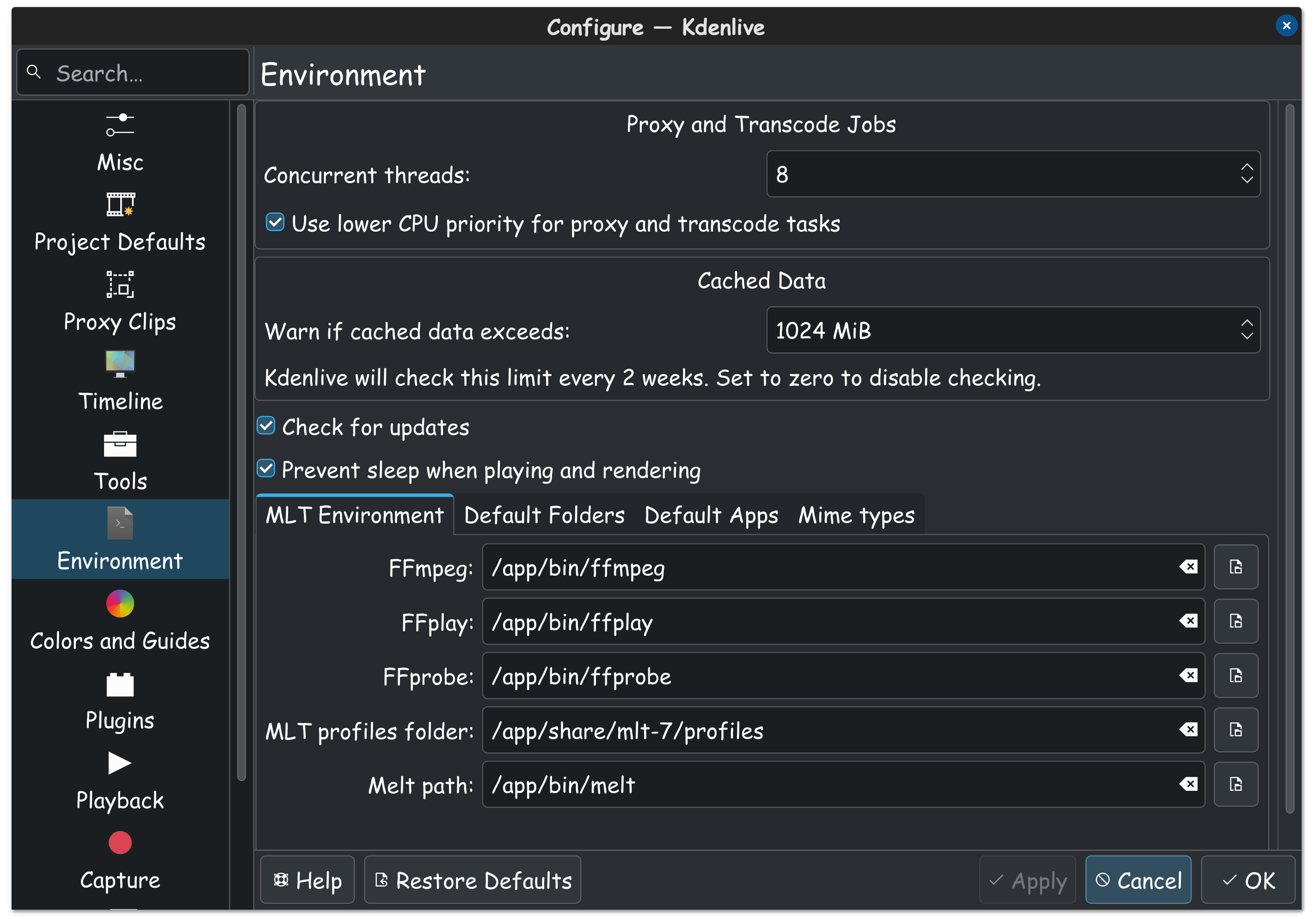

I have fairly modern hardware, Nvidia RTX 3080, and when I tried to use my Nividia GPU, it didn't like it either. I really believe that production workloads, was always meant for the CPU, which is why I made sure to get an 8-core 16-thread CPU.
What you want to do, is dedicate more threads to your CPU in Kdenlive, and you will see a boost of rendering speed, even at 4K! This is how you do it...
(1) Click on "Settings" at the top, then click on "Configure Kdenlive."
(2) Click on "Environment" on the left. Default is 2-threads, I have 16-threads available, so I set mine to 8-threads to be safe. Make sure to click "APPLY"
This will speed up Kdenlive Project working overall.

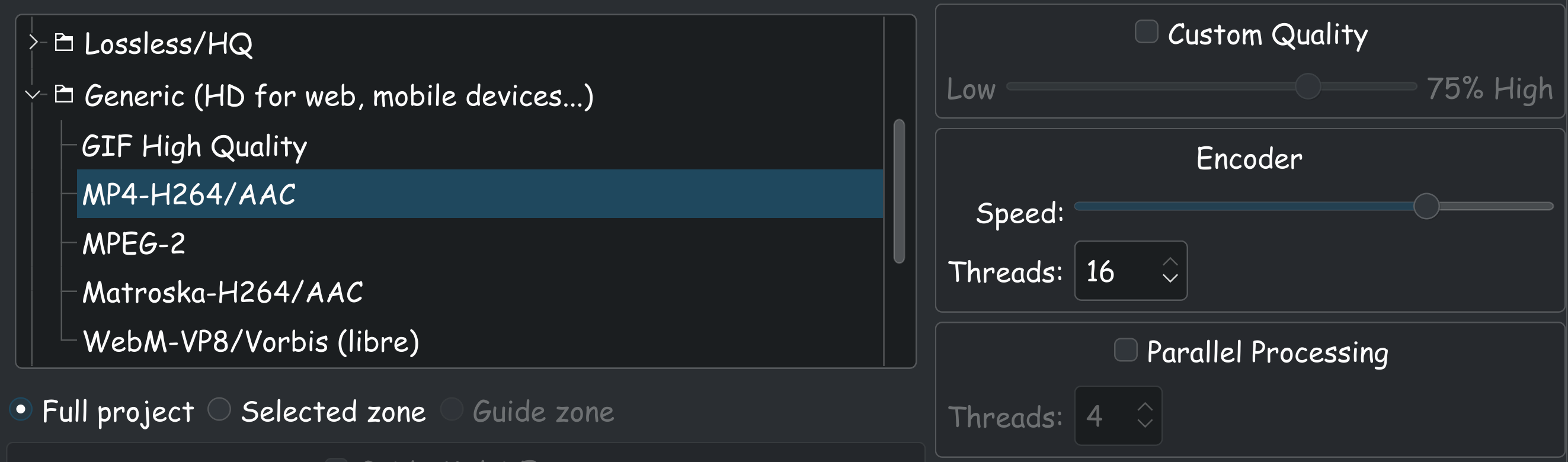

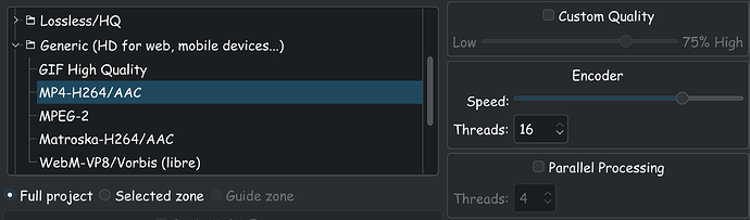

(3) Its even more important to set your Encoder rendering threads, we do this when your in the render portion of your video. I set this to 16 threads
I also set Encoder speed to 3/4, this speeds up rendering.
(4) Do not enable Parallel Processing, while it sounds like a nice to have boost, according to Kdenlive, using it will add artifacting to your video's.
