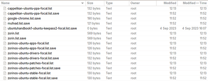

Hmm ... Okay, open the File Manager and go to /etc/apt/ and there open the File sources.list with Text Editor and post the Content of it here please.
Then go to /etc/apt/sources.list.d/ and show what Files are in it.

/etc/apt/sources.list.d/ :
After entering nautilus File Manager as root I have edited the Mullvad and Google files and commented out their contents. Previously I had removed their repository via the command line as per their documentation.

give us the content of /etc/apt/sources.list.d/ please

I see here mostly explicitly focal. That is not right. You would have to replace this with the Jammy one's. Otherwise, You don't have the right Sources. And when you only delete that, You don't have the Sources at all.
Is that everything in this File?

The contents of the focal .list and .save files are "jammy" versions of the package references . I have commented out all of these as per suggestion above by @Forpli .
