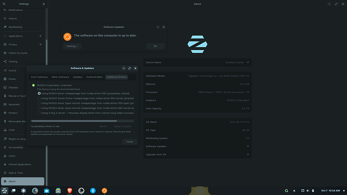

With both the core and Pro installs (not upgraded, replaced) Zorin 17.2 will not go to sleep when asked. It instead tries to. The displays go off but then come back on and show the lock screen. I'm wondering if this is a software situation where one program prevents sleep or if something in the OS is not liking it for some reason.
AMD 5700x, 4070 Super (newest driver 550?), running Stacer, browsers, remmina, and a few others.

Could you also send some screenshots of your current power settings and all the settings relevant to that? Just to make sure we don't have something simple going on here
