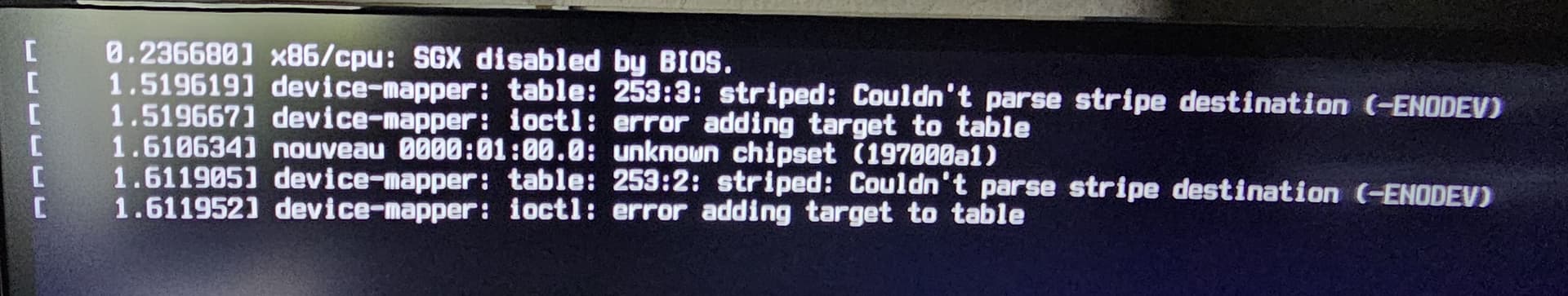

  • Boot seems to be puking trying to determine what that R10 array is.
  • I tried troubleshooting by booting the Zorin OS 17 USB Key and following directions to repair the boot using the system tools. It failed and wrote a Boot Record to https://sprunge.us/3Q4kC1

Boot errors:

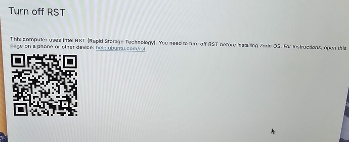

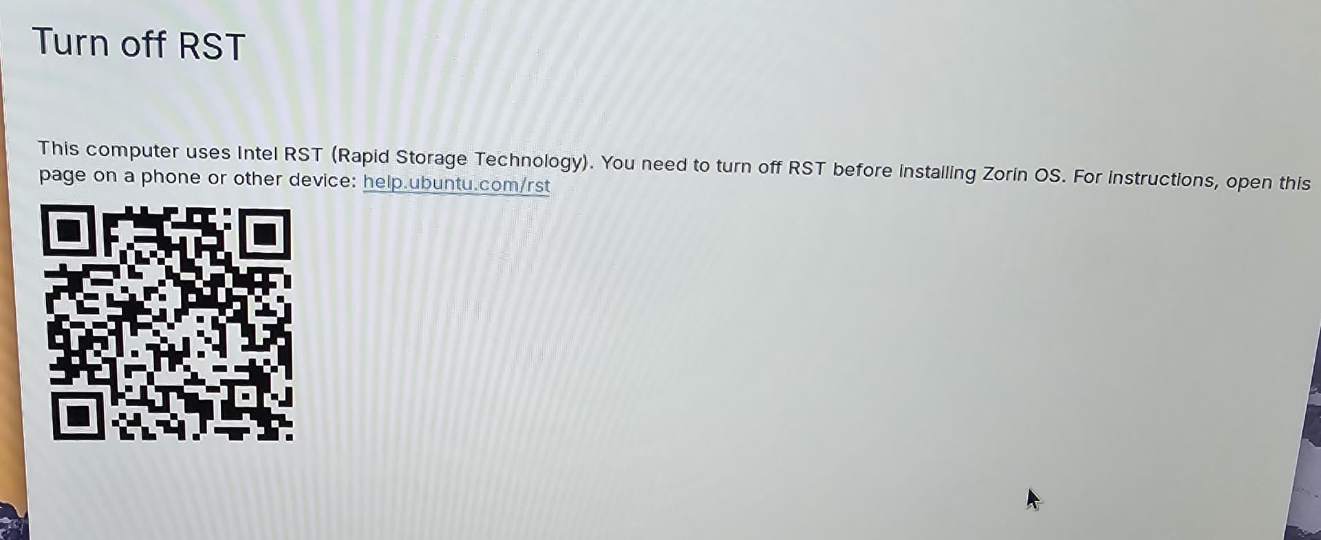

And trying to reinstall with RST enabled:
Now I've got to see if I can safely disable RST without fubaring Windows. :smiley:
