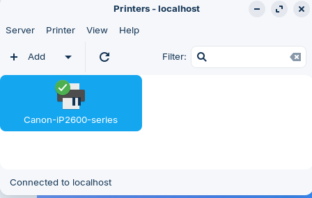

I use the latest zorin os (core) and I connected my Canon Pixma IP2600 which used to work with Windows 10. Zorin recognized it and installed gutenprint driver.
After the installation it showed the printer ready and connected but when I tried to print a test page it said that the page is printed although nothing happened on the printer

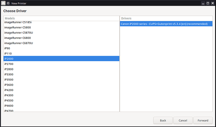

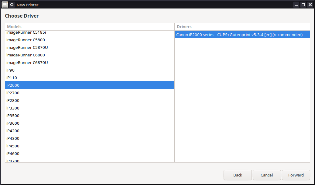

sudo system-config-printer
Next, click on Add - if networked, use AppSocket/HPJetDirect method and enter the IP Address of the printer in the top field. Then click on continue to select driver, then choose the iP2000 series driver:

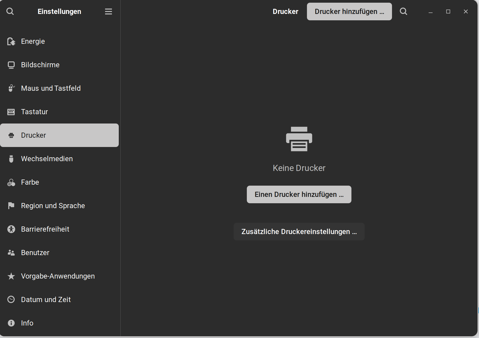

When You go to Settings>Printer is there Your Printer shown?
Hi @Ponce-De-Leon , if you check @dimitrisT first post you see he can.

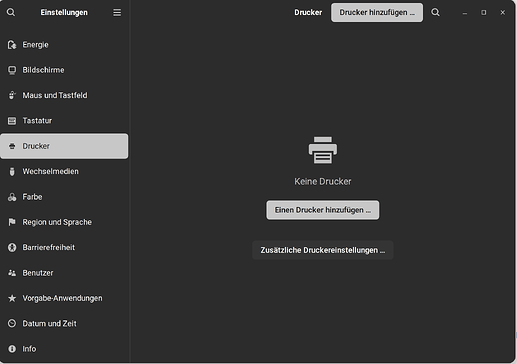

But his is not the Printer Screen under Settings>Printer. This look like this:
When You click on the 2nd Button:
Bildschirmfoto vom 2025-06-24 19-17-52
You get the Printers - localhost Window what You see in the first Comment.
