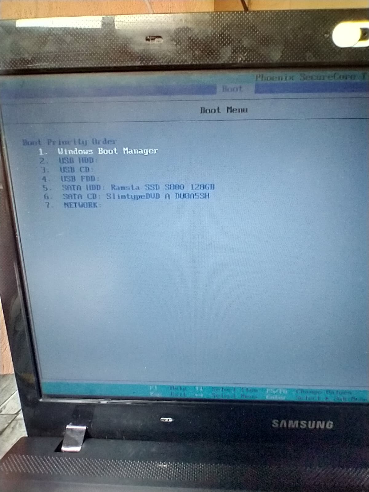

yes thats the problem, im not dual booting but the windows boot loader is number 1 priority no matter how many times i change the order the windows bootloader will always be at number 1. i tried on using another usb boot with windows 10 but still it doesnt boot as windows boot loader always be at the top. same issue when i use the usb with zorin. that is why i cant install new os and i am stuck on this situation.

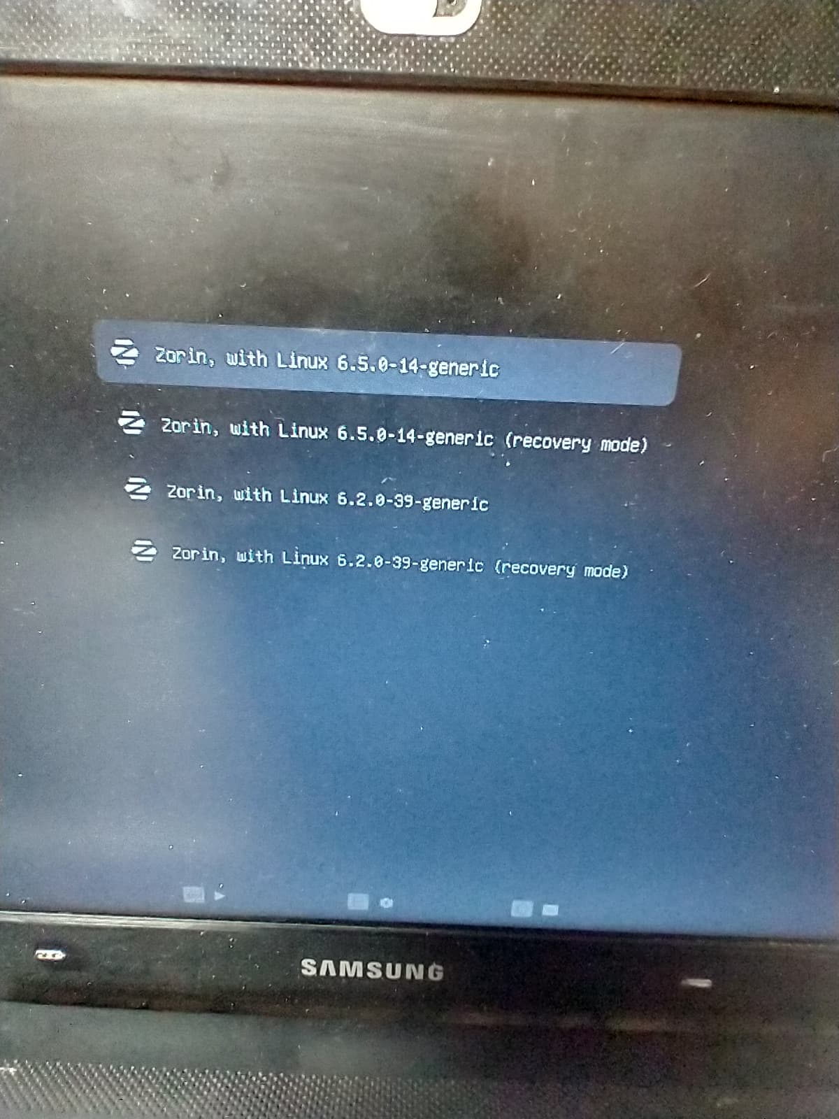

also when i open my laptop, i will always be loaded on 3 choices. zorin os, recovery (i forgot whats the name but it has 2 different version of zorin and 2 different recovery version of the two different version of zorin os), and last the uefi where i change the boot load order that does not work.

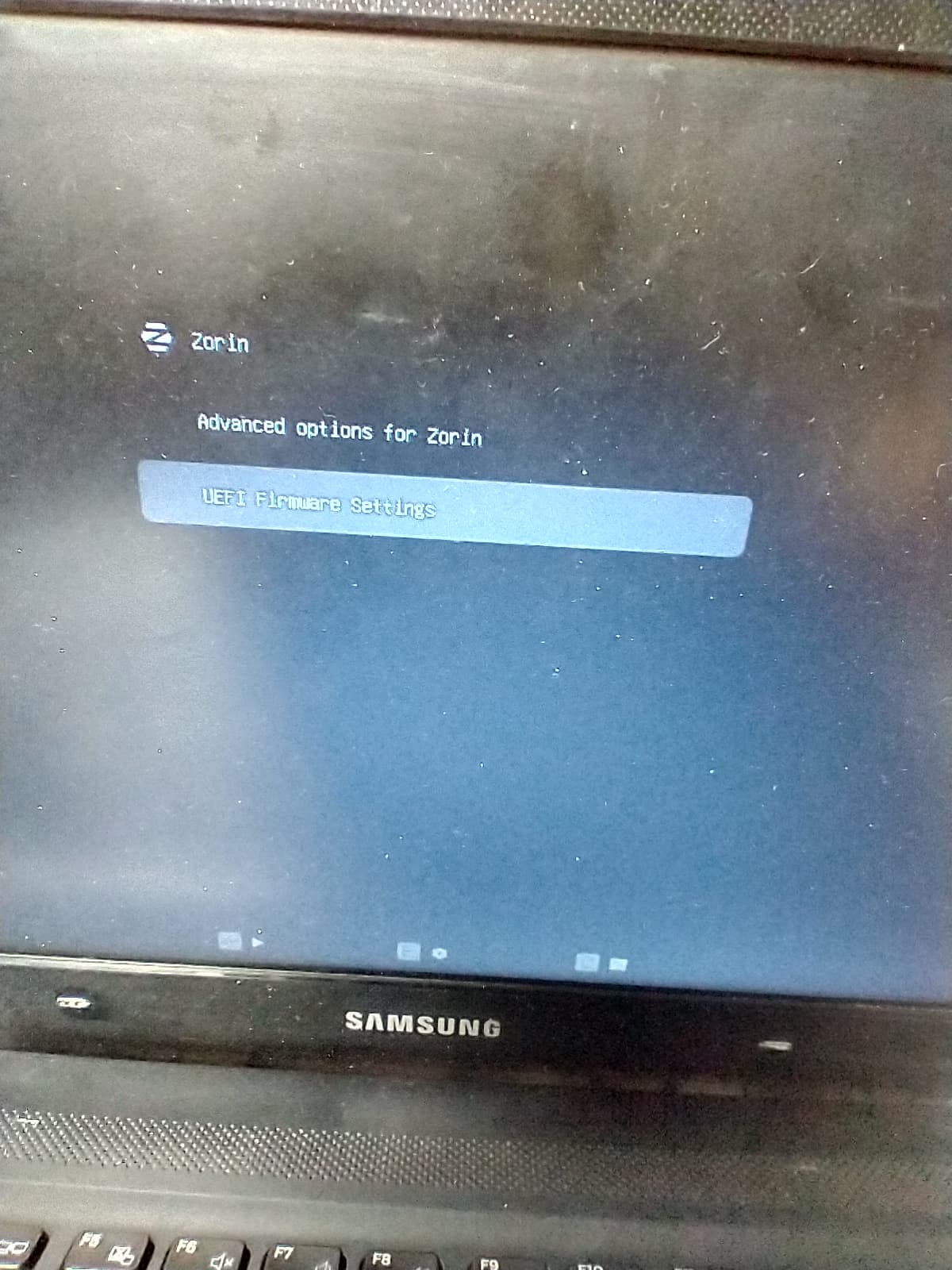

Here is the 3 log in what i always encounter when opening my laptop. Also theres the different version of the zorin iwas talking about its on advance.

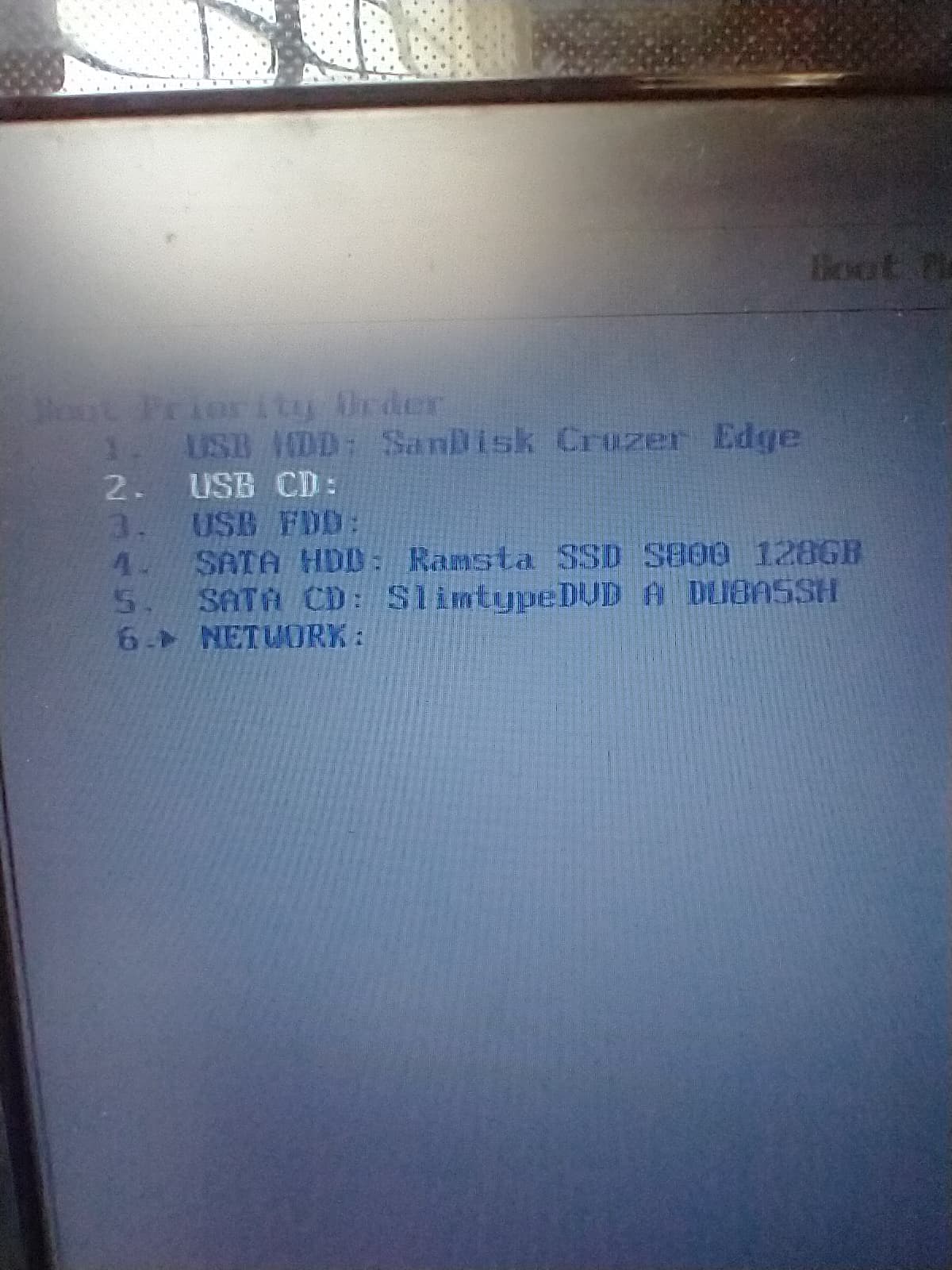

While this photo shows my bios boot order that when ever i put the usb on the first it will always be 2nd when i pres f10.

These are normal and necessary. They offer you the option to check your firmware settings, use recovery menu or boot a different kernel.

I got booted on zorin os not on usb even though it is on 1st

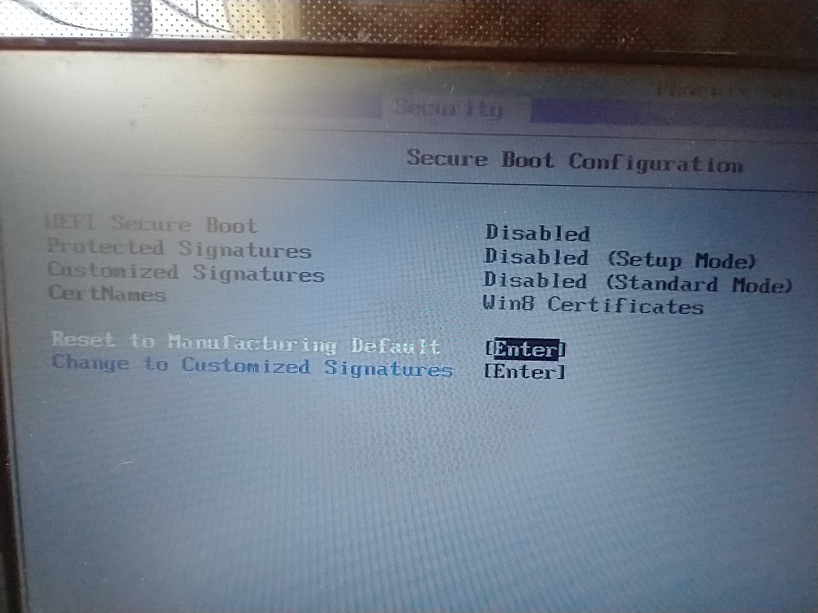

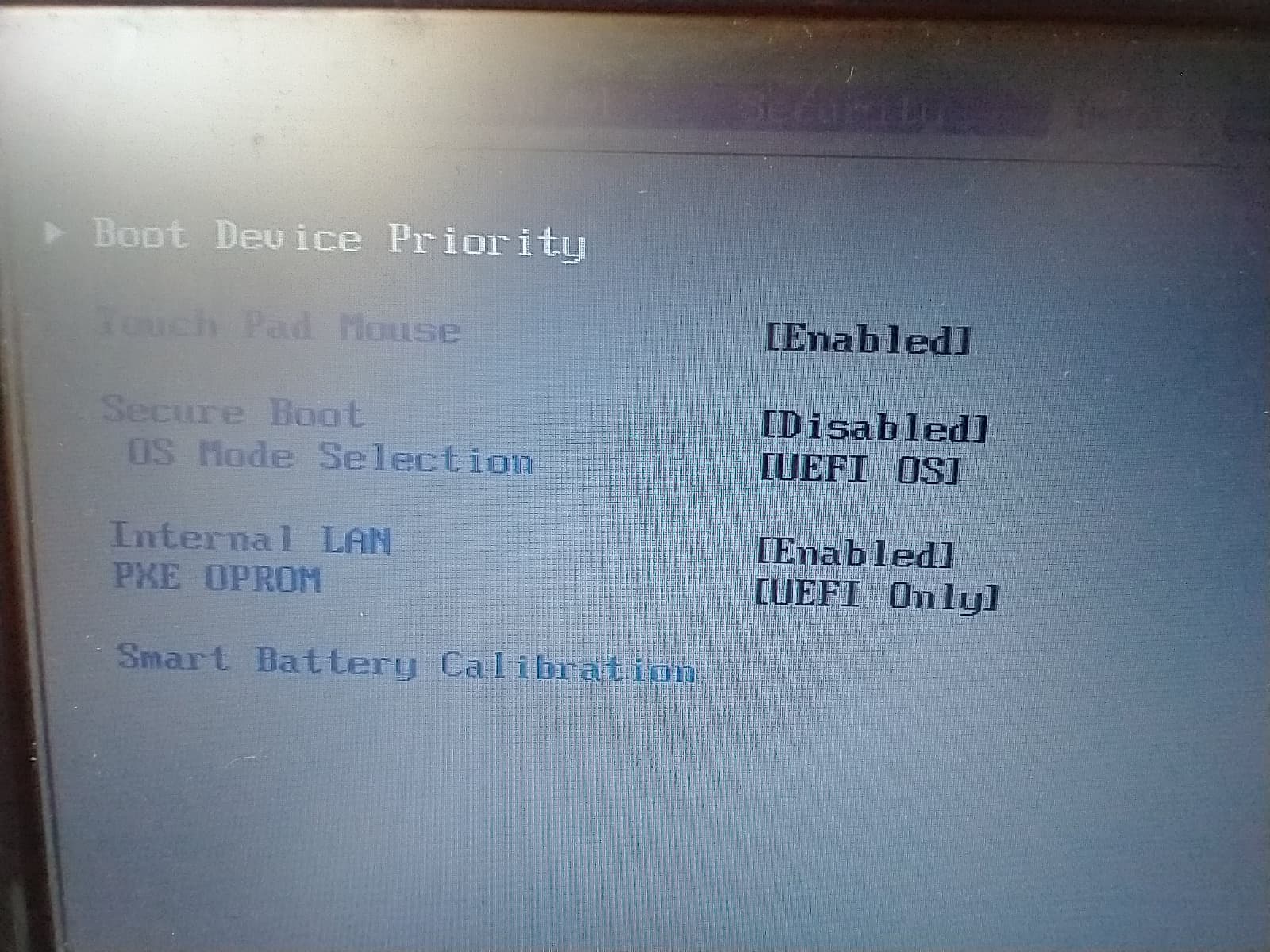

Is secure boot disabled in your BIOS Settings (It should be disabled).

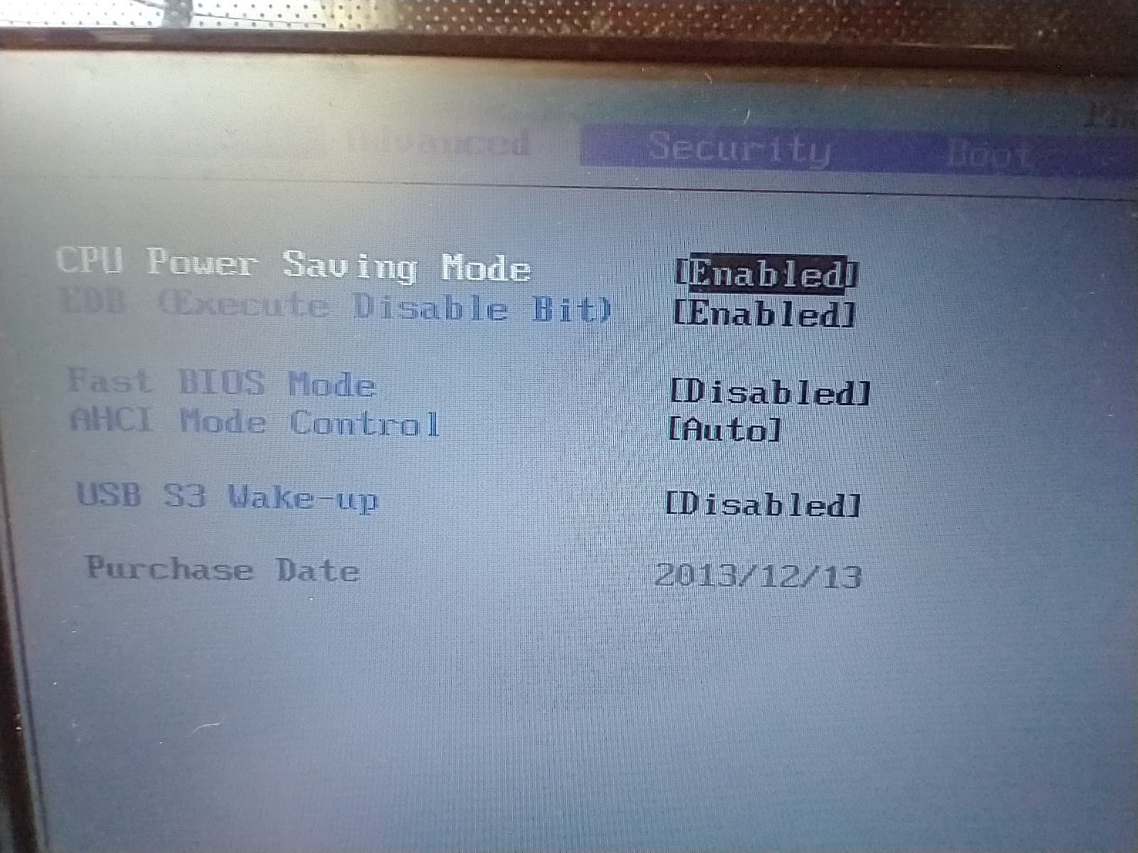

Yes its disabled even the fast bios. Wait for a few min ill try to use rufus again on the same usb to put another zorin os which is i need to download first from the website. It might take some time.
