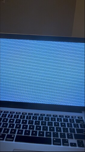

The next thing is more so an issue i have when turning the machine on and off. When i turn it on or off, I noticed that the screen flashes what i can only describe as a tv static type of effect for like 2 seconds and then it disappears. any idea what that could be?

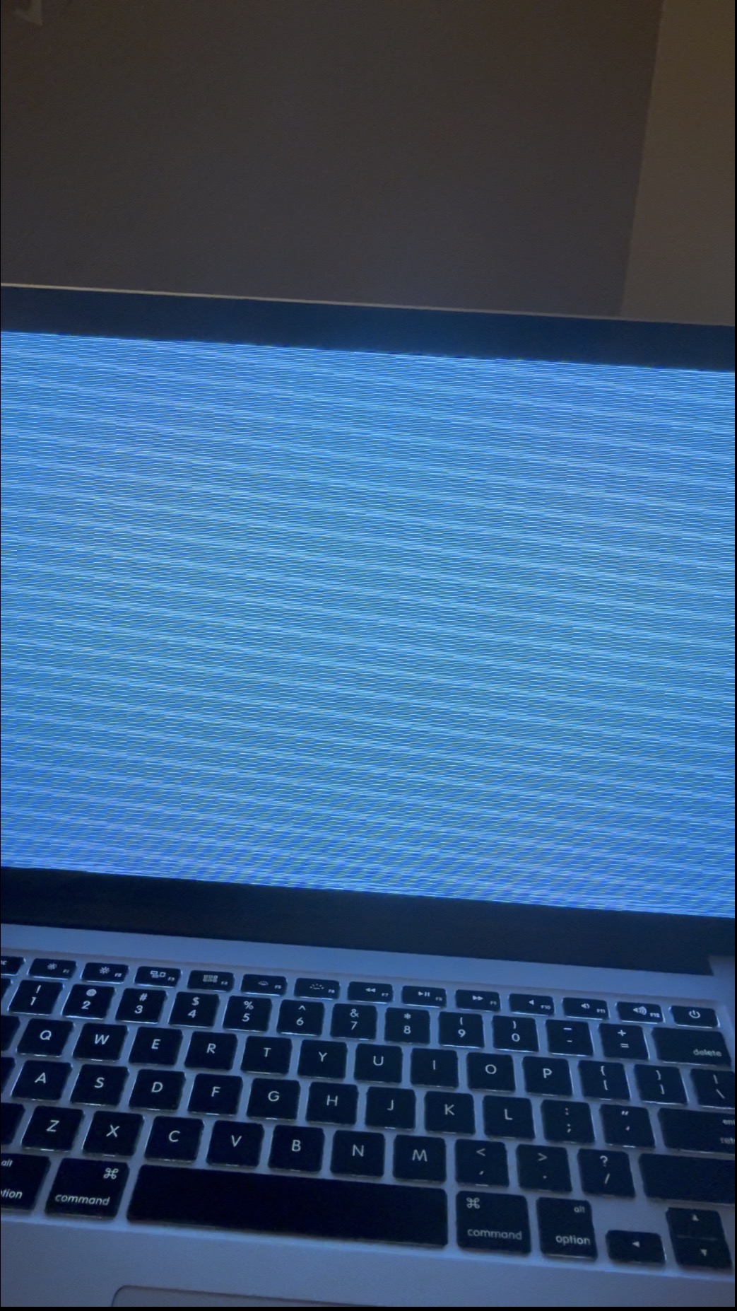

Edit: Here's a picture of what I see when turning the macbook on and off. Like i said it only appears for like two seconds and then after that it disappears. Doesnt effect normal function or anything. Just something thats shows up

the 2 second static flash on power on/off is pretty common on older apple panels under linux. usually the backlight / panel power sequence during modeset. if it only lasts a couple seconds and then the desktop is fine, most people leave it. if it stays or gets worse, grab dmesg | grep -iE "drm|i915|nvidia" right after boot.

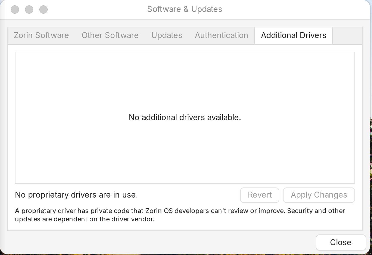

But please post a screenshot of the additional drivers site first, then we see more.
So i went and took a look at Software and Updates. There are no additional drivers available.
As far as what nvidia graphics card i have, after looking up the name nve7, it is a codename for the nvidia gk107 gpu. thats the nvidia graphics card i have. hope this info helps.

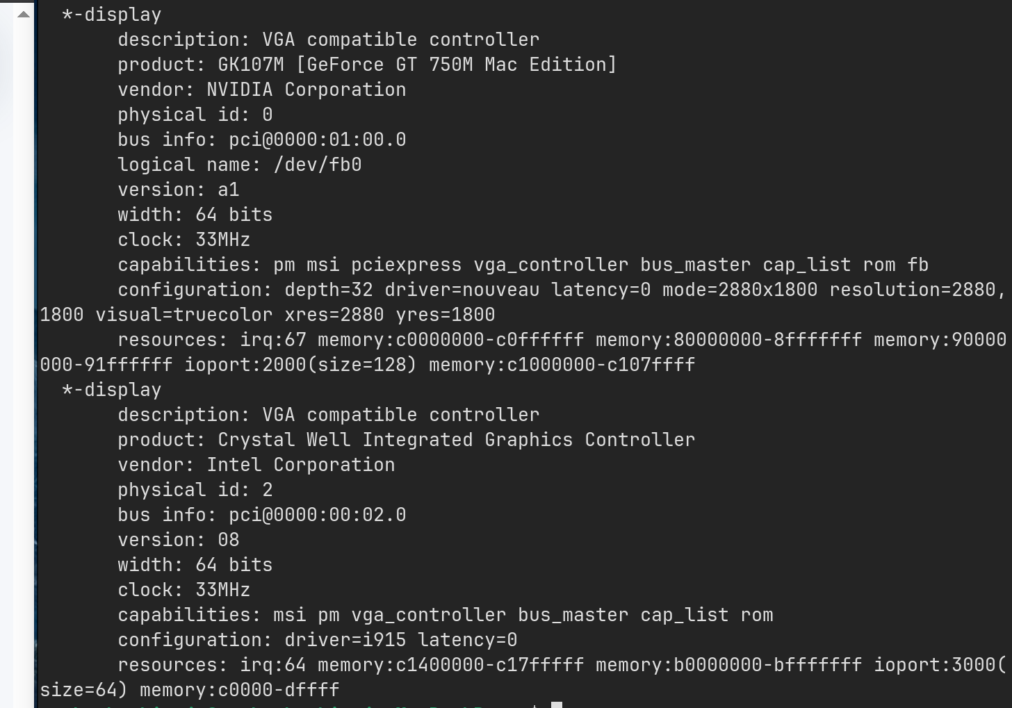

No Driver ... Could You type in Terminal sudo lshw -C video and post the Output here please? That should show further Details to Your Graphics Card.
Heres what came up when i entered the command you gave me
So i tried running it with Xorg to see if it ran better and nah it still overheats. gonna try a couple more solutions that people give me before just installing zorin os lite cause that seems like the move. Also on Xorg my mouse clicks randomly just stopped working which was odd lol.
Okay, a GT 750m. I checked that and You would need an older Driver - a Driver that isn't available in the Zorin 18 Repo's. Would it be an Option for You to use Zorin 17 instead? It still gets Updates.

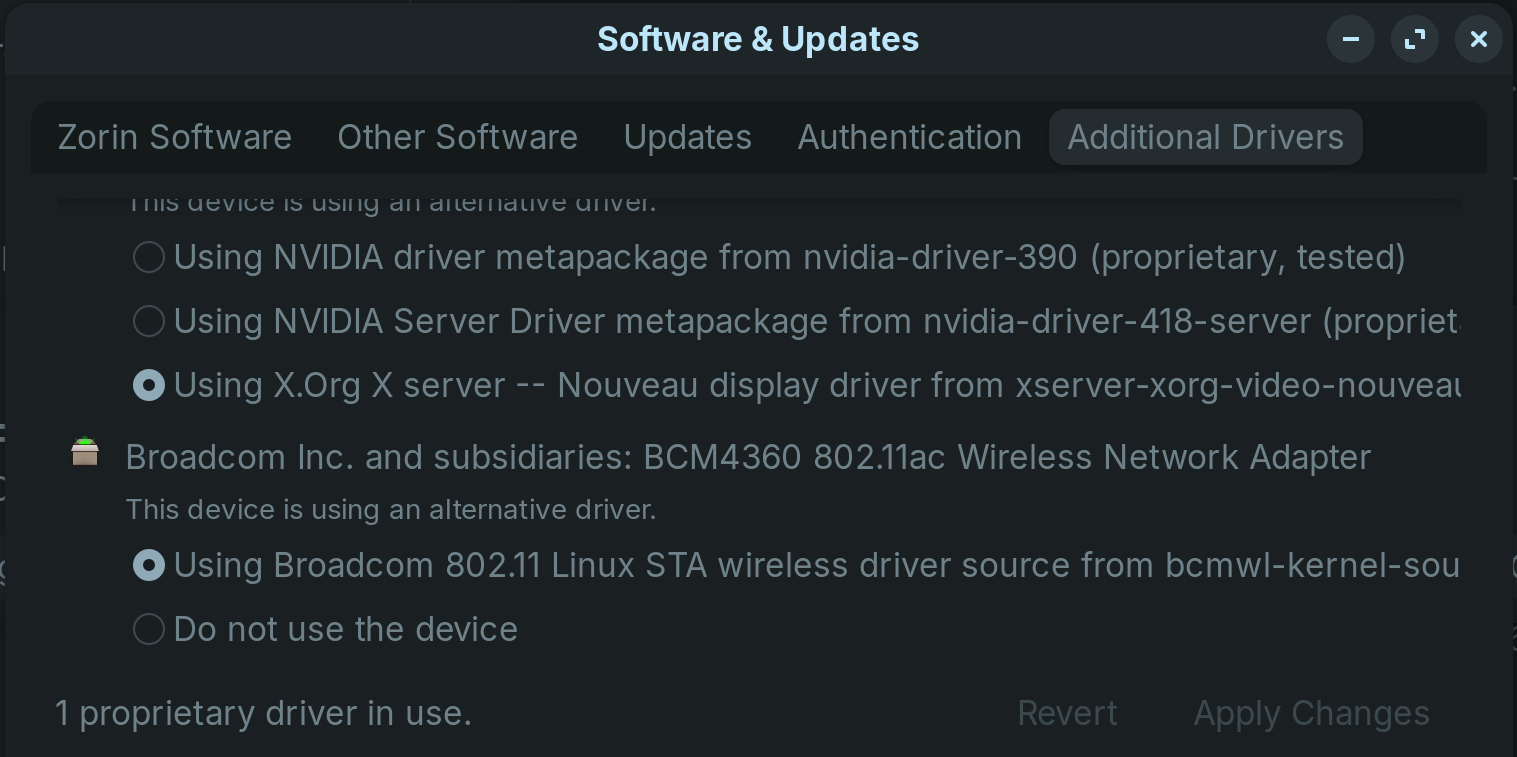

ok so i installed Zorin OS 17. for the additional drivers, which one do i need to install for gpu and network? i have the picture attached.
See if the 470 works:
Not sure about wireless, is it working? That screenshot states the driver currently in use but the only other option is to not use it and might mean no wireless if you selected don't use this driver.
