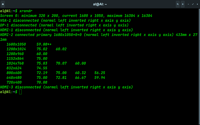

You should see your HDMI port/s listed in XRANDR
Check bios settings on HDMI.
Check firmware is up to date.
So you need to see your HDMI ports in Xrandr before anything else.
