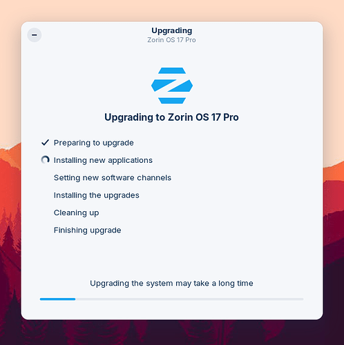

I have recently purchased Zorin Pro for Zorin 17; however, the installation process is running quite slow. It has been more then 3 hours, and the installation progress bar seems to be stuck in one place. I have both a high-speed internet connection and a decent processor, so I'm not sure what is causing this issue. Can anyone help me with this?
Edit: After 5 hours it completed but with an ERROR:

[INSTALLING NEW APPS:Flatpak] Error: { While pulling app/org.kde.kdenlive/x86_64/stable from remote flathub: While fetching https://dl.flathub.org/repo/deltas/Zt/39tUCEhsod8J_qIOUhT1SoZ7+xWpgHpfnasH2sF78/1: [92] Stream error in the HTTP/2 framing layer }
[INSTALLING NEW APPS:Flatpak] Failed

Upgrade Completed With Errors
Try remove kdenlive from your installation and run the upgrade again. You can always install it again.
Any upgrades/installs may take a few hours, my install of 17 (Not pro) took 1 and a half hours
Using the Direct Upgrade option has always taken me the range of 1.5 to 3 hours.
It is one reason I prefer the Fresh Install method. That takes thirty minutes.
And I get a nice fresh clean start.
For users that had a tricky setup of additional software like Printers or VPN's or other complex installations - using the direct upgrade option in Zorin Upgrader is a real boon.
But for most users, the fresh install would actually probably be preferable.
I have 3 hours installation on hard disk hdd but ssd going faster.
