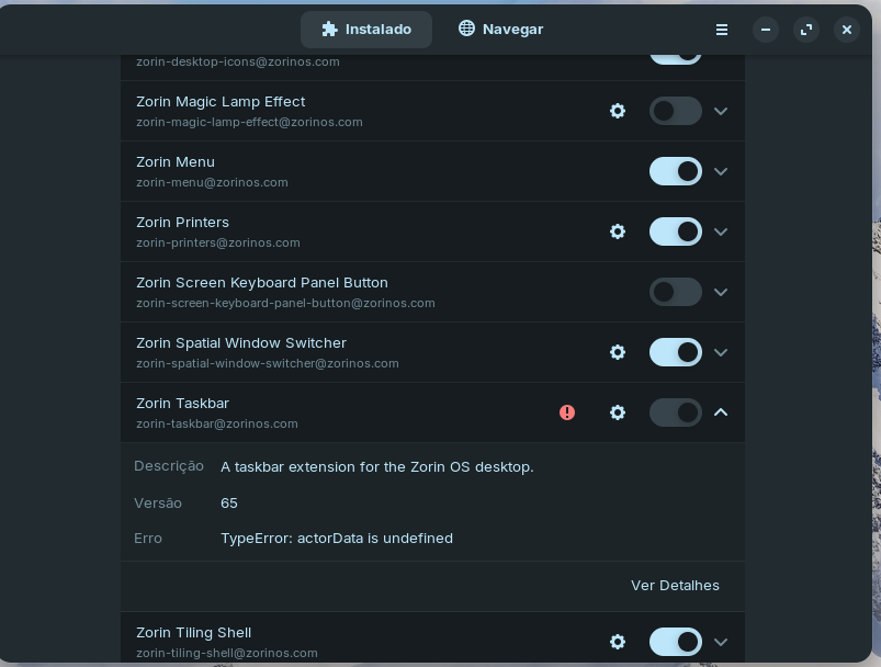

I installed the extension manager, and it reports an error in the taskbar, as shown in the image. The error described in the red icon is the following:
TypeError: actorData is undefined
In order to continue testing, I first need to fix this taskbar issue, and if there's a way to reinstall it, I'd like to know the most appropriate method.

We found that there was a regression recently introduced into the taskbar code. The regression caused this behaviour to happen when intellihide was enabled and the user logged out of the account and logged back in.
We've since resolved it in a new software update which will be published in the main software repositories shortly. However, if you wish to test this fix in the meantime, you can follow these steps:
  1. Download the new Zorin Taskbar package from here: https://launchpad.net/~zorinos/+archive/ubuntu/stable/+build/31324634/+files/gnome-shell-extension-zorin-taskbar_70.1.1_all.deb
  2. After downloading the .deb package, double-click on it to install this latest version.
  3. Finally, you can press the Windows/Logo key to open the Activities overview and search "Log Out" in order to log out of your account and log back in.
This should apply the new fix on your computer.

I downloaded and installed this .deb file you provided and restarted the laptop. The taskbar appeared exactly as I had configured it. I ran some tests, such as disabling the taskbar from appearing on two monitors and turning the laptop off and on, and it has been working so far.
Thanks for your help.
