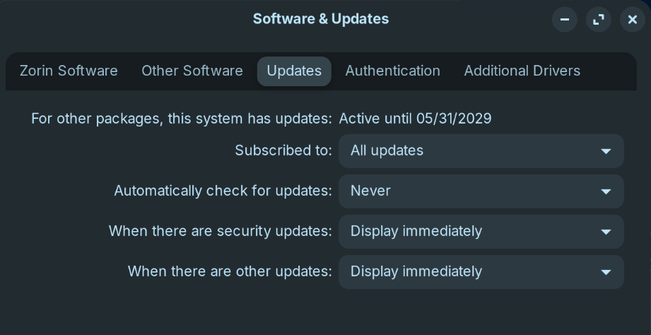

However, I tried to turn off these automatic software updater prompts. It is not supposed to automatically prompt me like this. But it still does. Please see the attached screenshot. How do I fix this?

The file /etc/apt/apt.conf.d/20auto-upgrades already has this configuration. But the software updater still pops up after a few minutes every time I turn on the computer and have updates pending.

I would prefer to avoid uninstalling the software updater, in case doing so would break my system in some way. For example, I notice in the GUI that there are a lot of zorin-exclusive PPAs and packages listed there. I do not want to mess that up somehow by uninstalling the software updater. Nevertheless, I will consider trying this if I am unable to otherwise solve the problem.
