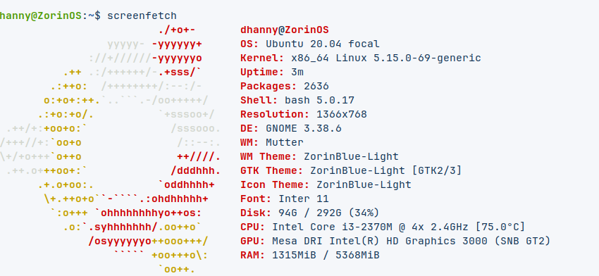

ZorinOS 16.2 has been changed to Ubuntu 20.04.6 when I performed "sudo apt update && sudo apt upgrade -y". Is there anything I need to do? I noticed that the base files installed are from the Ubuntu version, not the ZorinOS version. Thanks
I checked and nothing else has changed except for the base-files and software updates. How can I revert back to the ZorinOS 16.2?

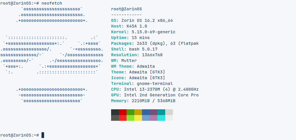

Der Panzer, are you on Core or Lite?
What is your output for neofetch or screenfetch?
ZorinOS 16.2 Pro

I just ran all available updates and rebooted - still shows Zorin OS as the OS name:

i think problem in base-files . base-files installed for ubuntu 20.04.6. I will try Reinstall Used Base-files ZorinOS 16.2.

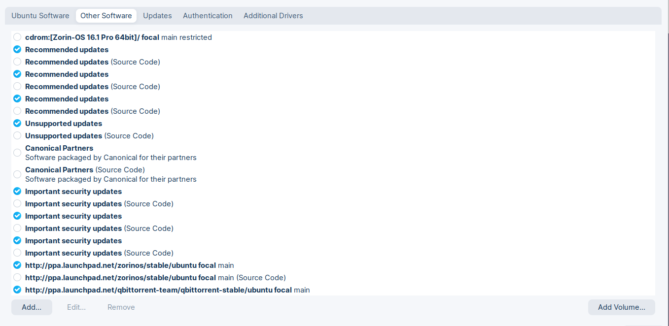

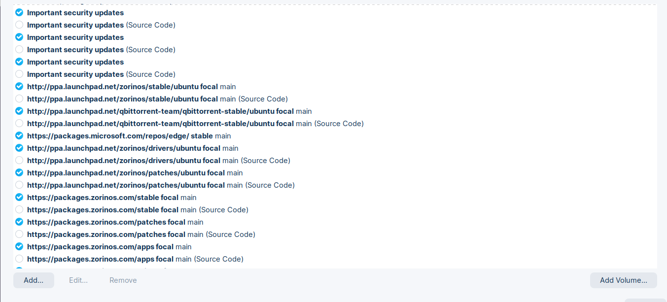

Is there any difference between this? I am still confused as to why I am experiencing this issue. ![]()
Honestly seems like, somehow, you installed base Ubuntu files over your Zorin install. Maybe you were installing something and it overwrote your OS with 20.04.6
