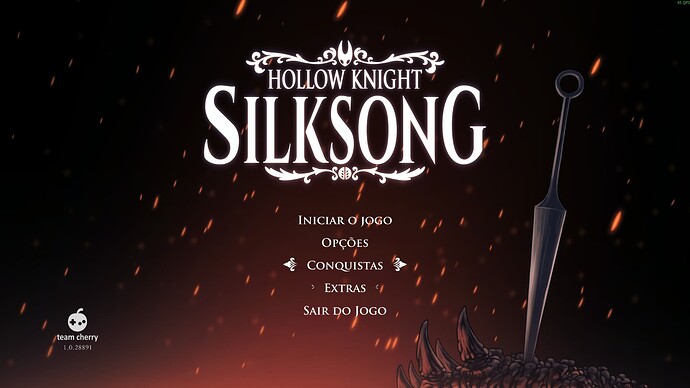

ZorinOS 18, Hollow Knight: Silk Song Perfomance lower with two screen on mirror mode
I was playing Hollow Knight: Silk Song on Zorin OS 17.3 on my TV using the mirror screen configuration because of the convenience of not change the screen mode, when I installed the Zorin OS 18 I noticed that the game gets a lower frame rate most of the time, usually getting 45 FPS what doesn't make any sense, this problem only happens if on mirror mode, if I extend or use only one screen the FPS stay normal.
