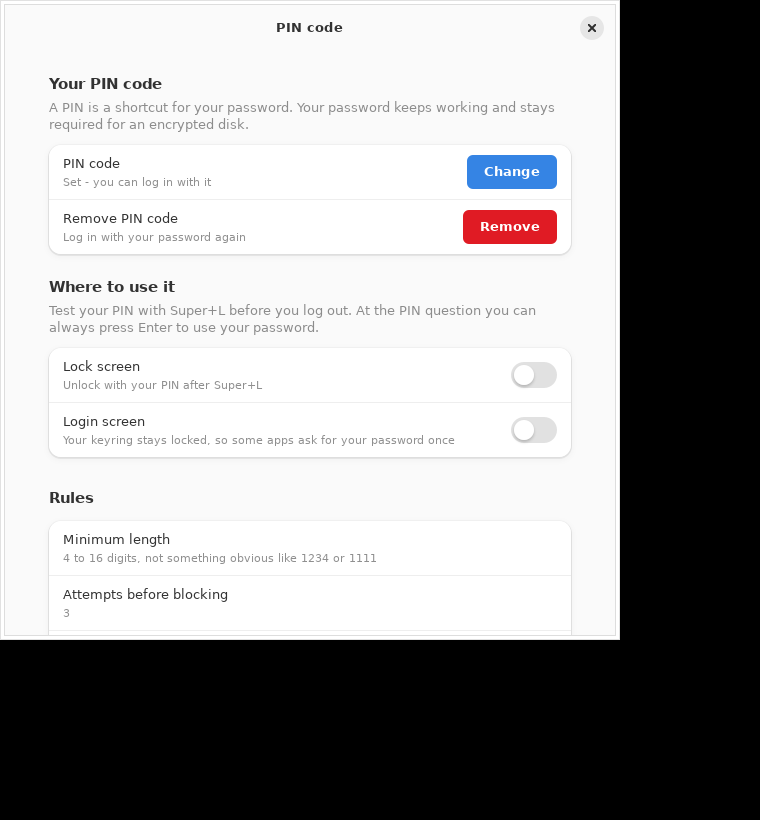

I missed one thing when I moved to Zorin: unlocking my laptop with a short PIN
instead of typing my full password every time. So I built it, and I would like
to share it in case it is useful to anyone else here.
GitHub - Hersenpap206/ZorinPin · GitHub
The PIN code settings window
What it does
  • Unlock the lock screen (Super+L) and/or log in at the login screen with a PIN.
  • A settings window called PIN code in the menu, in the same style as GNOME
    Settings, where you set your PIN and choose where it is used. Search for
    "pin", "password" or "users" and you will find it.
  • A command line tool (zorinpin set, zorinpin status, …) if you prefer that.
  • Works on Zorin OS 17 and 18, and on other Ubuntu/Debian systems with GDM.

The password is set by default to digits only, but you can change it in the
/etc/zorinpin/zorinpin.conf file (edit the file with root rights by entering admin:// in the pathfield of the topbar in Nautilus file manager) and set for digits_only no instead of yes.
If you like to have more freedom in the choice of your password, e.g. to set 1111, also set the line forbid_trivial from yes to no (but the password is not as safe then).
To be able to use the PIN also for sudo legitimation, run
sudo zorinpin-pam-config enable sudo
Then logout and login again.
